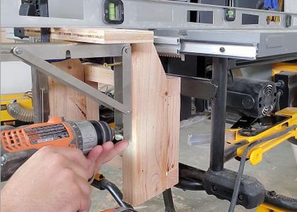

Step 1: Creating Mounting Points
Take a good look at the frame of the saw and look for 4 good solid mounting points. It will be different for every saw. I have a DeWalt DWE7491RS and there are two bolts near the bottom that I attached "L" brackets to. Then I drilled two holes in the upper frame to use to screw the new outfeed frame to later.

First I built a small square frame out of 2x2 that contacts the 4 attachment points.
Then I cut 2x4 pieces to attach the first piece to the folding brackets.
I cut out any areas that needed clearance. Then I attached the 2x4 to the 2x2 square frame with screws and glue. Then I attached the "L" brackets.
Finally, I attached the assembly to the saw with the "L" brackets and the top screws from behind.

Next I attached the brackets to the frame with screws. The most important thing is to make sure the brackets are positioned so the 3/4" top will be slightly below the table saw top.
