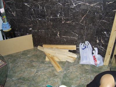

Ok... so this was not an exact science but i will list what I used to make it.
1. Tank ( We went to about 20 different pet stores and the most ideal we found was a 20 gallon tank that was 1 foot high)
2. Wood ( Home Depot was a great help, we mentioned what we wanted to do and the guy was so excited he didn't charge us for cuts ) Great time saver!
a. 1/2" MDF board base of the table
b. 2" x 2" x 8'. I needed about 3 of these
c. 2" x 4" x 12'. I needed only 1 of these
NOTE: Wood dimensions are stupid and are not exactly 2" x 2" just remember that for later
3. Wood Filler. This will make the appearance of 1 solid piece of wood.
4. Paint, Mini roller, edger
5. Drill
6. Screws 1 1/4" and 2 1/2"
7. Stuff i sure i missed like tank decor etc. That was the wife's dept lol

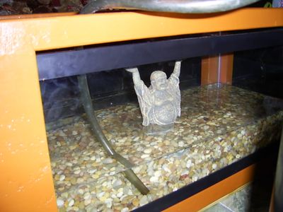

Step 8: Finishing Touches
Final things that we added on.

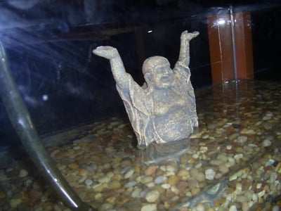

we placed little rubber cushions for the glas tops on the 4 corners, and also placed medallions on for a nice finishing touch.
I mounted a 6 outlet adaptor to one of the feet underneath to supply the pump and filter with power, we ran the wires out a corner at the top of the tank and hid it by running down the inside of one of the edges, running the cords under the table and plugging it in.
Place the glass on top and voila. table top tank.
Total cost $250. If bought new over $700. With the savings we went to the casino :)
