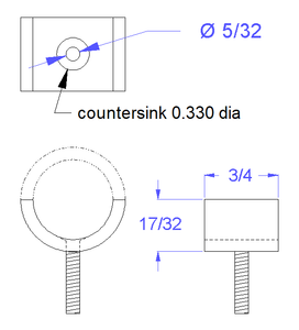

With the hacksaw cut the 3/4" PVC in half, then drill a 5/32" dia hole centered with a 0.330 diameter countersink.
Insert the 6-32 FH screw into the hole and epoxy it in place, keep it straight, as shown. To keep the screw straight, I took a wood scrape 1/2" thick, drilled a 5/32" hole in it, then using a piece of waxed paper between the scrape and the mount, I applied the epoxy to the underside of the screw head, inserted the screw through the mount, waxed paper and scrape then tightened the assembly with one of the hex nuts.

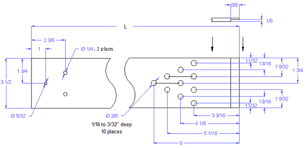

First a short discussion about what's going on. The cannon is loaded by placing a ball bearing, the bowling ball, into the muzzle of the cannon. Then to fire it take another ball bearing, the trigger, and place it in the trough and give it a slight nudged towards the muzzle. As the trigger gets closer to the muzzle it accelerates from the pull of the magnet and hits the magnet, the firing pin, and passes the acceleration from the trigger to the ball through the magnet.
To find out how long you're going to make the alley depends on the strength of the cannon, so it needs to be tested.
Here you have to be careful, mount the cannon on a piece of scrap 1" wide with a 5/32" hole for the screw, place it on a flat table, surround the flight path with towels to prevent the ball bearings from getting lost. Fire several rounds to see how far they go, choose a distance that assures you the ball has enough force to knock down the pins, make the length of your alley (L) about 8 inches longer. Put a 5/8 x 1/8 notch at the end of the alley to catch the ball (dado, router, plane or file) and drill all the holes as specified below.

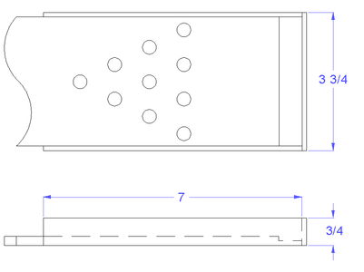

To contain the ball we've installed a fence made from the particle board around the alley and catcher for the ball.

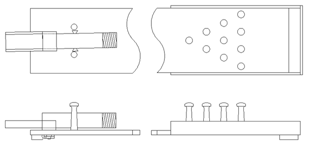

To maintain the focus on the bowling pins the 2 extra Shaker Pins are installed to prevent the cannon's aim from leaving the alley.
After drilling the 3 holes, glue the two extra pegs to the alley.

Install the mounted cannon to the alley by putting the screw through the hole and attaching the nuts. The first nut should not be too tight to prevent the cannon from pivoting and the second nut tight enough to prevent the first nut from coming loose. Set the ten bowling pins in their tenpin layout.
