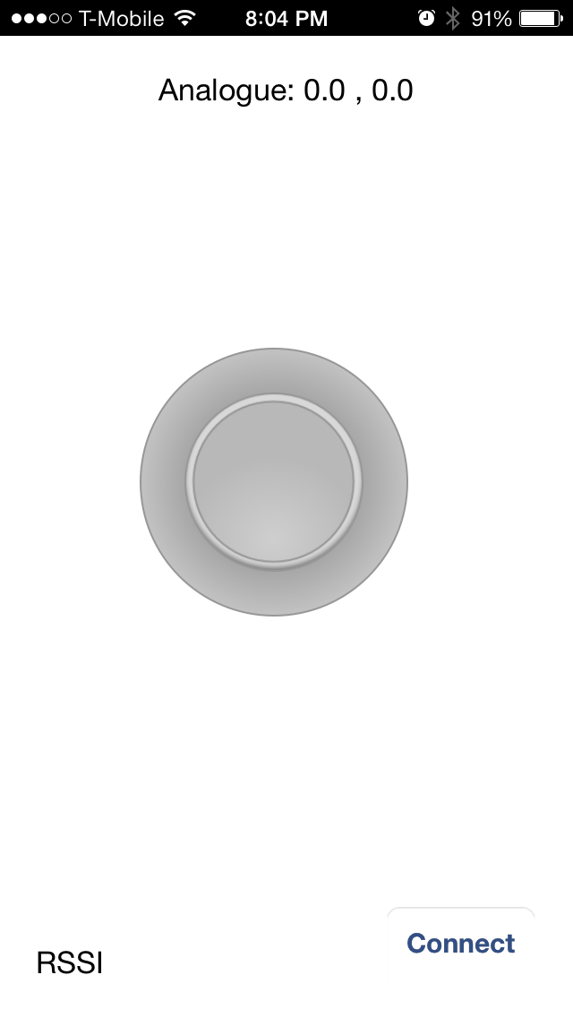

For the iOS interface we're going to keep it simple and just use a typical Analogue game pad and a connect button. the code for the Analogue stick control comes curtisy of https://www.cocoacontrols.com/controls/jscontroller
should note that the SDK from red bear labs can also be used to Mac OS X applications....
In order to build the project and run it on a physical device you will need to join Apples iOS developer program, and have Xcode installed.
Grab the code from https://github.com/scottCheezem/BlueRCiOS/tree/LED_example
I've included the headers from Red Bear Labs and the Analogue stick controls. It should be ready to build and go, but I've only tested it on my iPhone 5 with iOS 7 beta 3
The project is built from a single view template. Joystick, a label for the signal, and a button to toggle connections - what more could you ask for in a remote control app.
Step 4: Upload Sketch. Build & Run.
If you've gotten this far, you have the LEDs wired up, the Sketch uploaded on your Arduino, and the Xcode project running on your iOS device. After you press the connect button and see the bluetooth icon indicate that you are connected to the Arduino you should be ready to interact with the Sketch. As you move the analogue stick around on the iPhone, the LEDs light up. If you press the toggle button, the iPhone vibrates.
