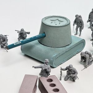

I'm showing you how I made the Tank Pencil Sharpener using cement. You can make it by making a mold using PVC film and Foamex, and pouring cement dough into the mold. You can see a brief description of how to make the Tank Pencil Sharpener here, or you can watch a video that shows how to make it in more detail. If you want a manual, you can click the link in the video information.

Step 9. Once hardened, carefully remove the mold. And then attach the pencil sharpener to the inside of the turret by aligning it with the pencil hole.
Step 10: Done!
Step 10. The Tank Pencil Sharpener has been completed.
