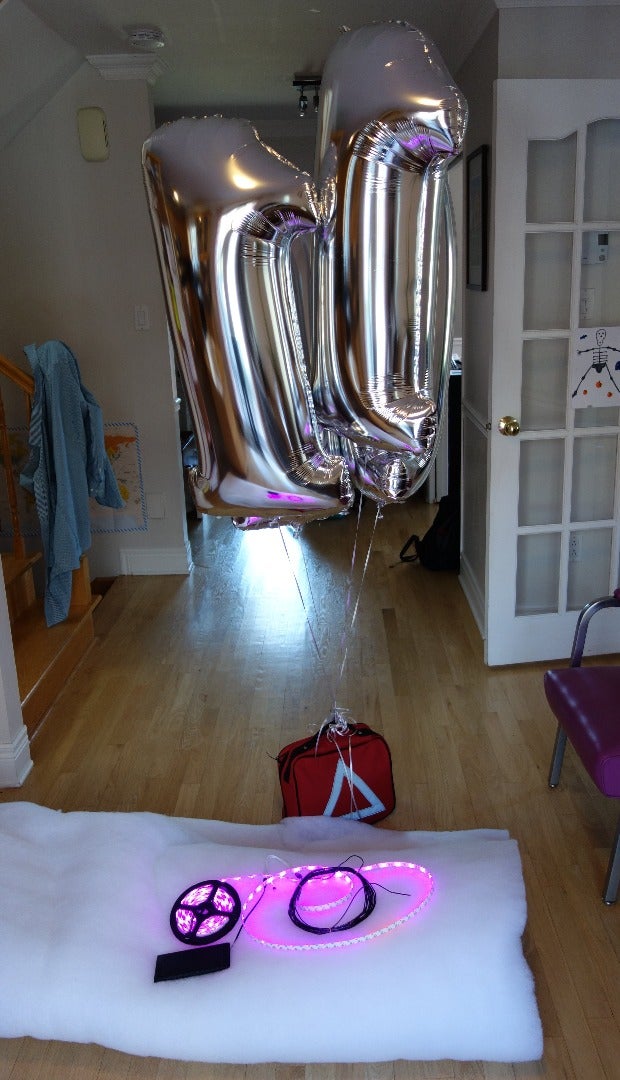

For the cloud you will need the following items:
  1. 3 x 40 inch #1 foil balloons 18$ amazon
  2. 4' by 6' of quilt batting 10$ amazon
  3. A length of LED lights with a battery pack 25$ amazon
  4. Some packing tape, a strip of coroplast
  5. A pole and stand (I used a fake bamboo pole and a small tripod, but it wasn't ideal)

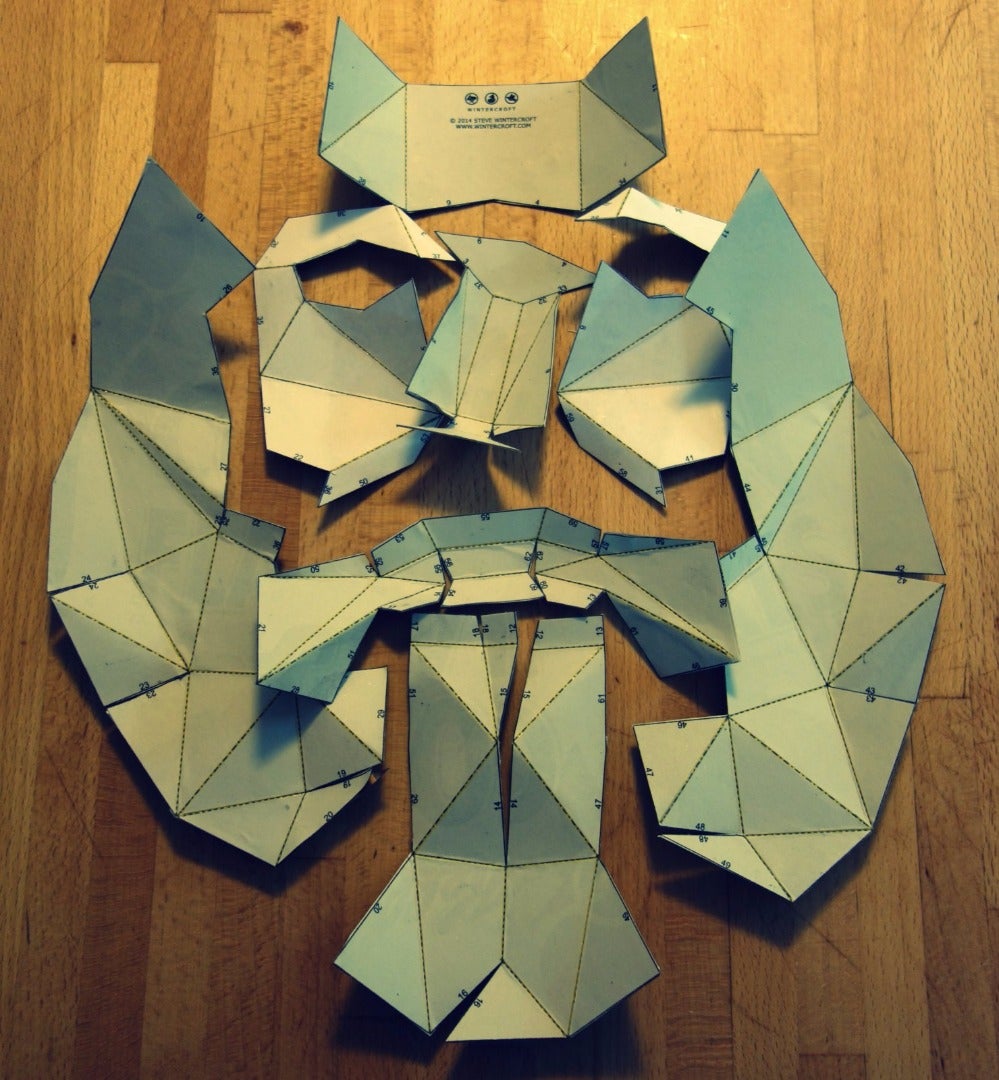

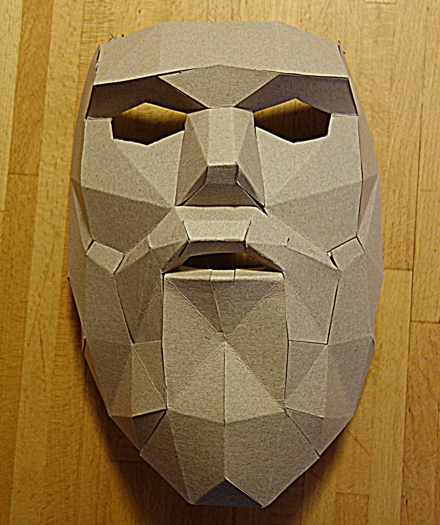

Step 1: Low-Poly Mask
There are some really great low poly instructables available, but I wanted to leave the geometry for the experts this time around (I had enough technical hurdles to overcome). But if you are looking for inspiration please check out: kamibox.de's Big Head or Krumrey's deer mount; there is a specialized software called pepakura that I plan to add to my toolset eventually. So I took a shortcut, and purchased a template from Steve Wintercroft (very cool site with lots of mask templates). The steps for assembly are very similar regardless of the template, the photos are from an early attempt (3 in all).

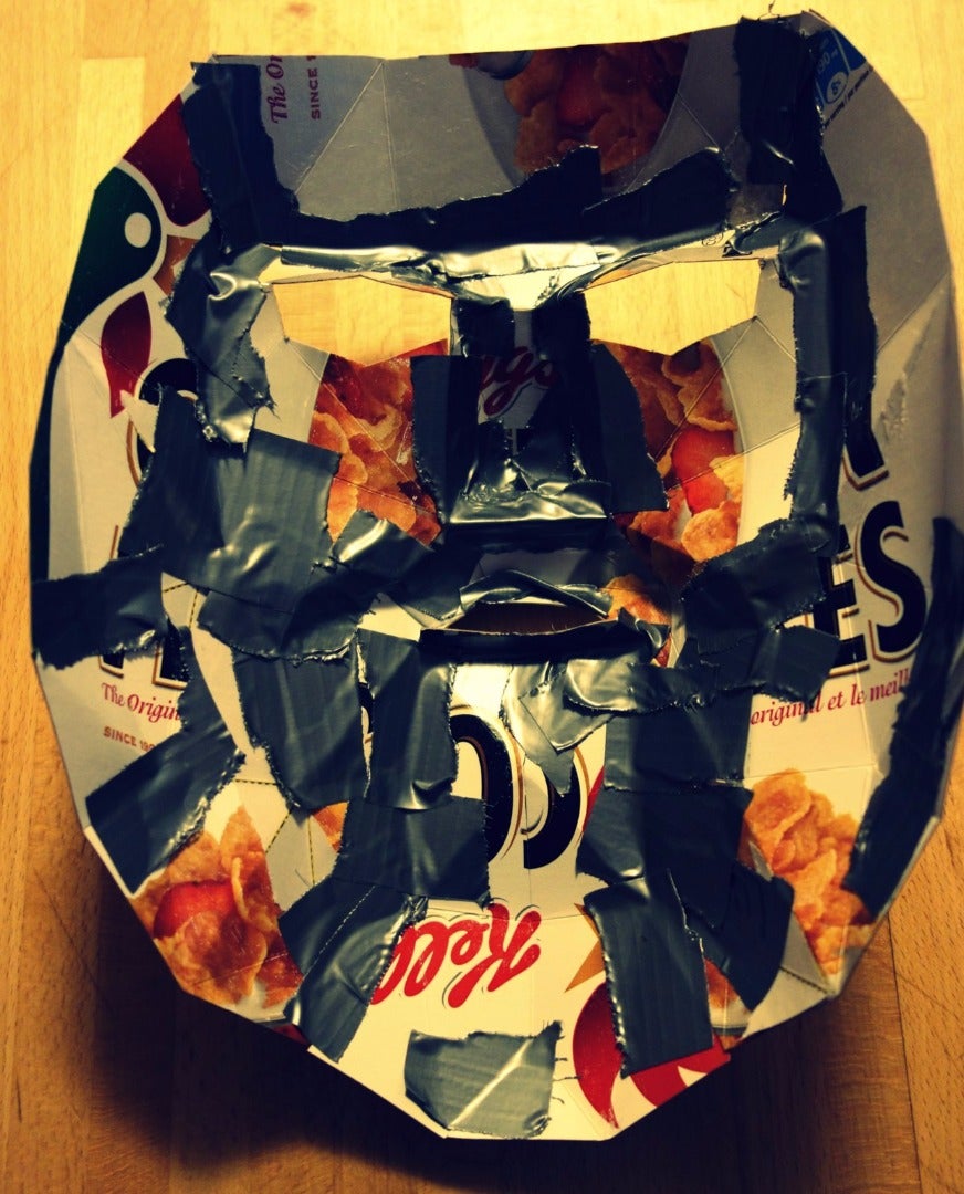

  1. Print the template onto the recommended paper size
  2. Roughly cut out the paper being careful to not cut along folds or any of the templates
  3. Glue the template onto the card paper (Corn Flakes box in this case) the nice side of the paper should be on the opposite side
  4. Score the fold lines with a ball point pen, if you can find a pen with transparent ink you'll be able to preserve the lines indicating if it is a mountain or valley fold
  5. Carefully cut out the card paper along the solid lines from the template.
  6. Fold the card paper according to the line type on the template (mountain or valley).
  7. Tape the pieces together. Wintercroft suggests taping on the outside with invisible tape, but I preferred to tape it from the inside with duct tape.

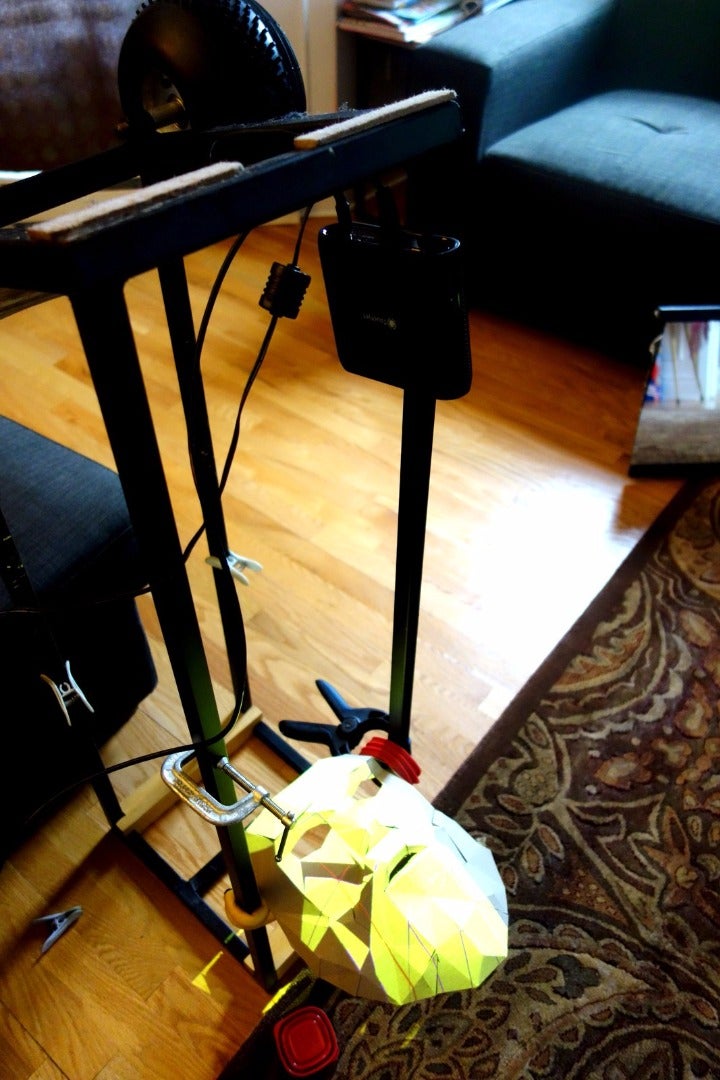

Step 2: Projector Mount Challenges
This was the most difficult part of the project. I went through many versions before settling on the design you see here; there are a few other things I would like to try (adding a lens to shorten the throw). Some of the things that I tried included using a mirror to keep the weight more centered, the projector oriented vertically and horizontally.
Challenge: Stiffness and Predictability
The ultimate goal is to have a fixed and predictable geometry so the the projection can fit with the mask's polygons under real world situations. The slightest change in angle between the projector and mask is immediately obvious, and is detrimental to the effect. This was achieved by fixing an aluminium angle bar in slots sawed in an old bike helmet. Tie-wraps were used to keep everything in place. It's not pretty, but it worked.
Challenge: Weight Distribution
Another major challenge is the distance of the projector from the mask: the larger the projection area, the further you have to place the projector and the more downward force it creates at the front of the headset. After a few trials, I wound up adding a lead-acid battery to the back of the helmet as a counterweight. The size and weight of the resulting headgear balanced but cumbersome and the rest of the costume was adapted to hide this.
Future technology should provide solutions: smaller projectors and better batteries, along with short throw lenses will keep the projector light and close to your face.
Challenge: Projection Geometry
You can't have the projector directly in front of the mask or else you can't talk with anyone without smacking them in the face (I did that a few time anyway); the projector will also be in the line of sight of any viewers. To solve this issue, I made the projector boom angle up at about 15 degrees; this reduced my strikes to a minimum (3 lamp strikes and a few bonks to the heads of my friends). This angle also increases the projection coverage in the vertical direction: think of how a spotlight beam grows as you angle it from straight down (tight circle) to an angle subparallel to the target surface (very elongate ellipse). This was beneficial for me because the mask was relatively long, so I could put the projector closer to the mask and help deal the with the other challenges discussed above. A drawback of setting the projector at an angle, is that the down-facing polygons will not get any light. I didn't care too much in my case because it gave an ominous look: dark below the brow ridge.

Step 5: Zeus' Cloud

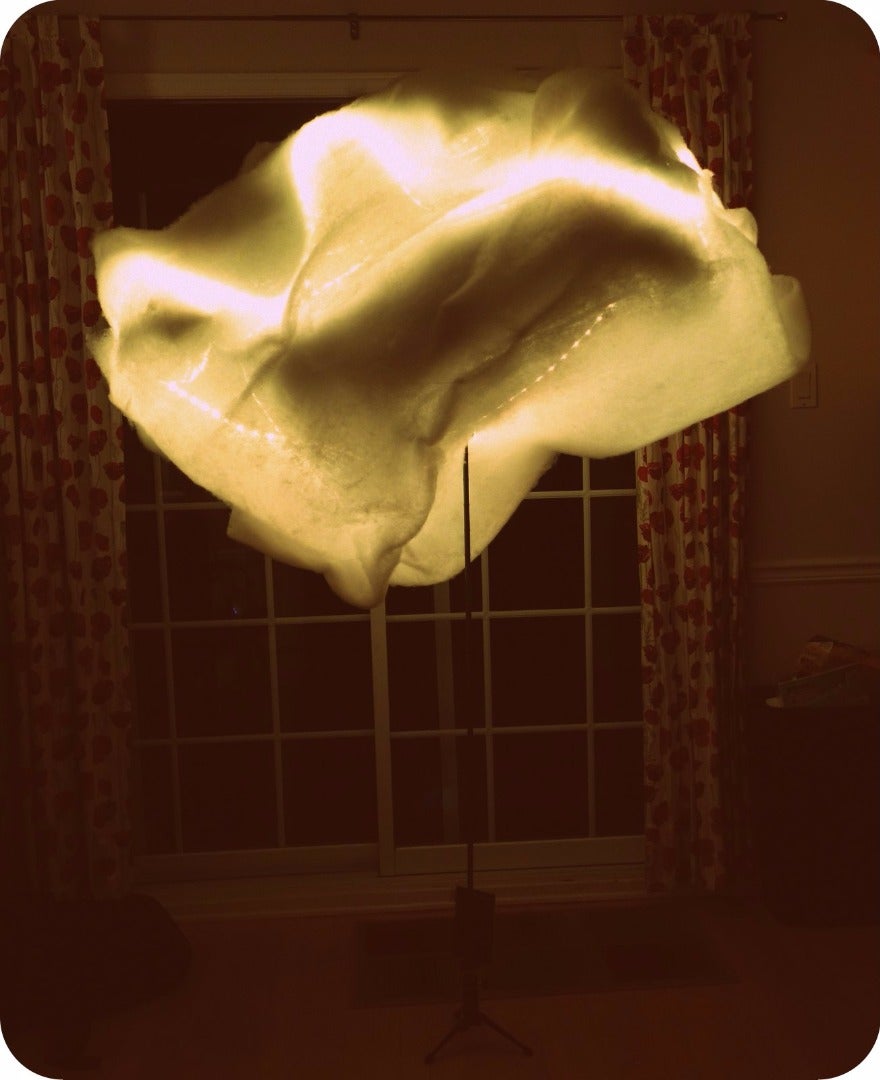

Zeus needs a thundercloud to go along with his lightning bolt. I've been wanting to attempt the amazingly realistic examples like this or this; admittedly my attempt was not as convincing, but still very eye catching and relatively mobile. The initial concept was to have the helium balloon have sufficient buoyancy to hold up the quilt batting and the lights. I had purchased some more lightweight LED lights, but the impact of the changing colors from a separate and heavier strip outweighed the effect of a self-floating cloud, so I went for a cloud on a pedestal instead. I hindsight I wouldn't have needed helium fill in the balloons, but the girls are having fun with them so not all is lost.
  1. I used a steel pole to hold up the cloud, but I wanted it to be tethered to a tripod, so I welded a bolt onto the base of the pole that could be threaded onto the tripod.
  2. I drilled a hole near the base of the pole to thread the cables that I used to connect the battery pack to the LED controller.
  3. I connected and soldered the 4 connections.
  4. I peeled a part the batting to make it thinner and more irregular in texture.

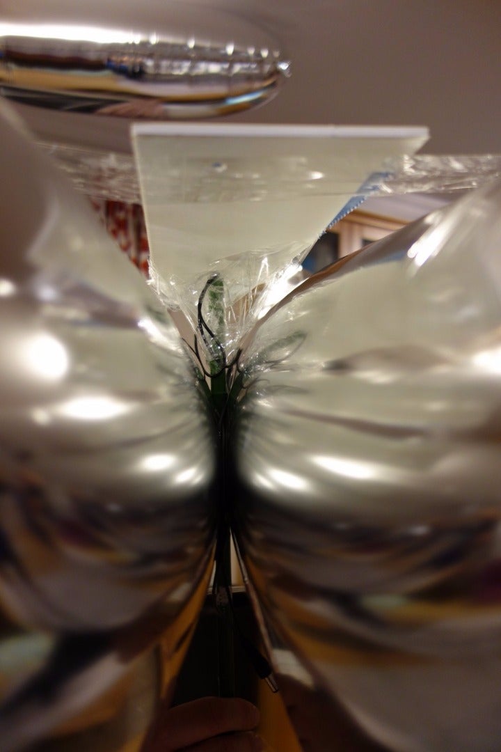

  5. I taped the bottom two cylindrical balloons together.
  6. I inserted the pole through the center of the batting and between the two balloons.
  7. I cut a strip of coroplast and taped it to the top of the pole to protect the balloons and provide a little more control when turning or pulling the cloud through a crowd or doorway.
  8. I taped the third balloon onto the first two with a slight offset to have a more interesting geometry.
  9. I taped the LED strip in spots letting it hang like a garland around the edge and underneath the balloons
  10. I wrapped the balloons with the batting and used some white thread to hold it closed and to make some folds. These folds give a much more cloud-like dimension to the project, but I found that the result was not as convincing as the examples mentioned above. In fact the DJ at the bar I went to for Halloween called me Cocoon Man...
