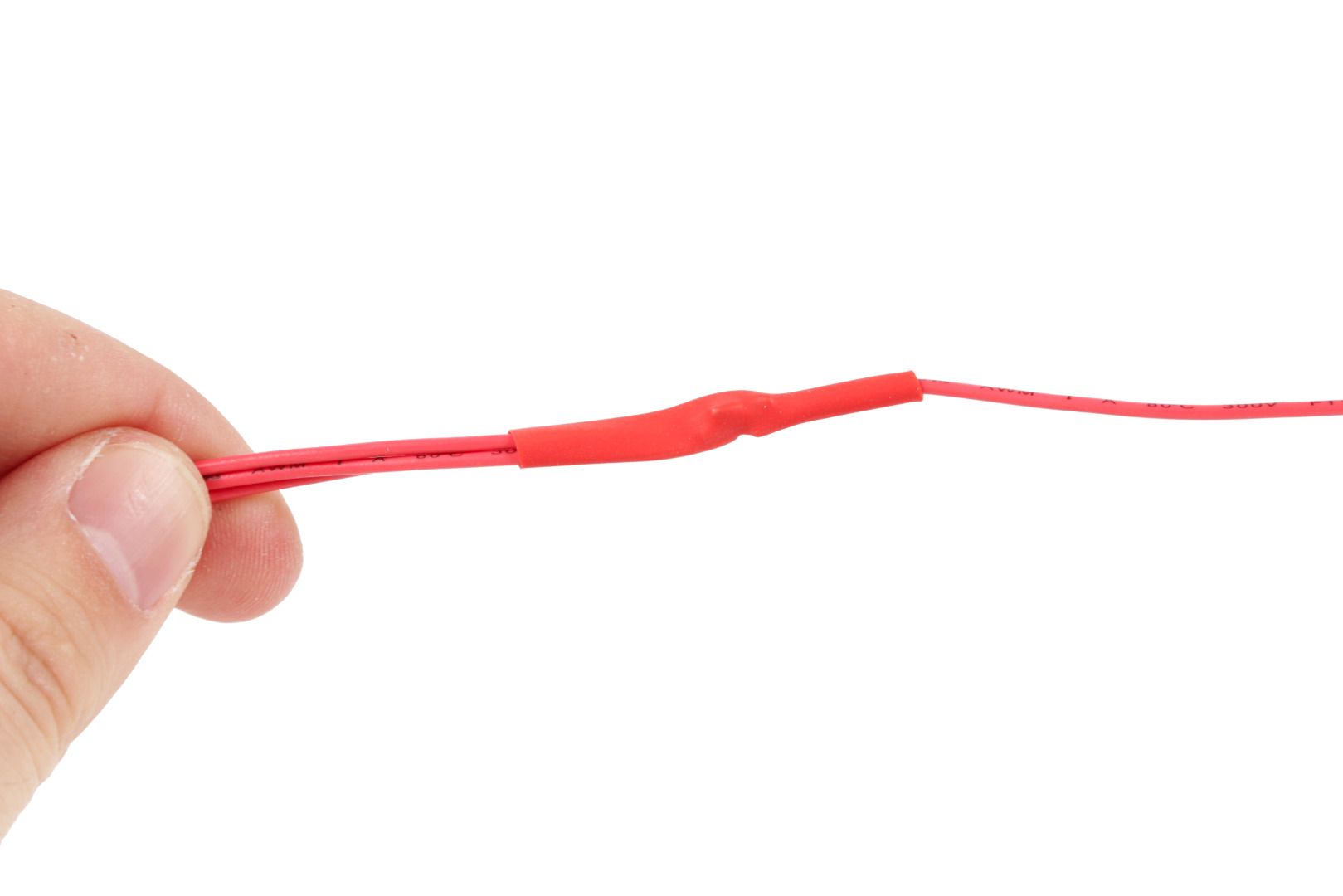

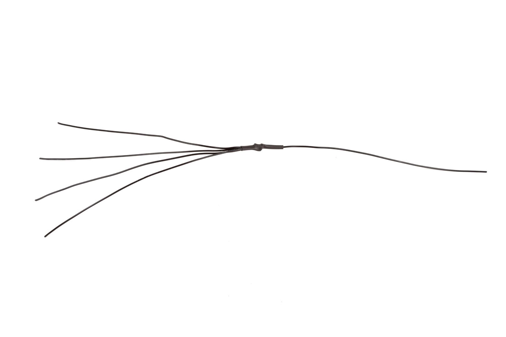

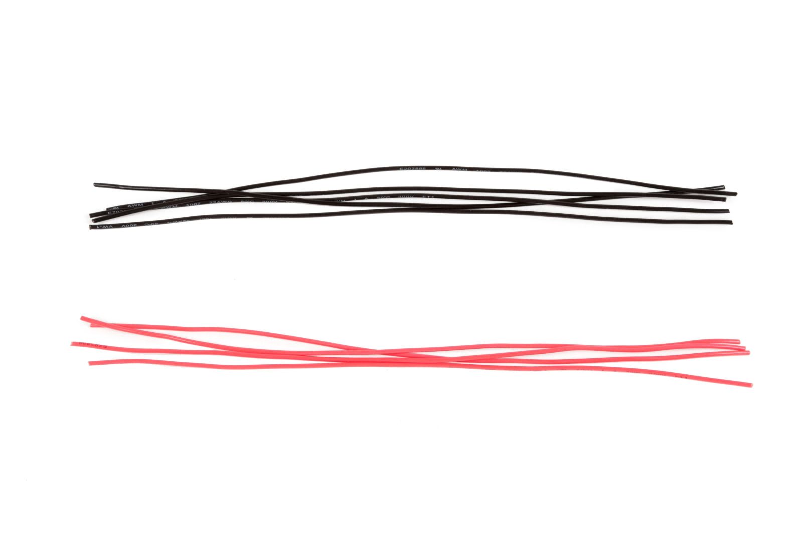

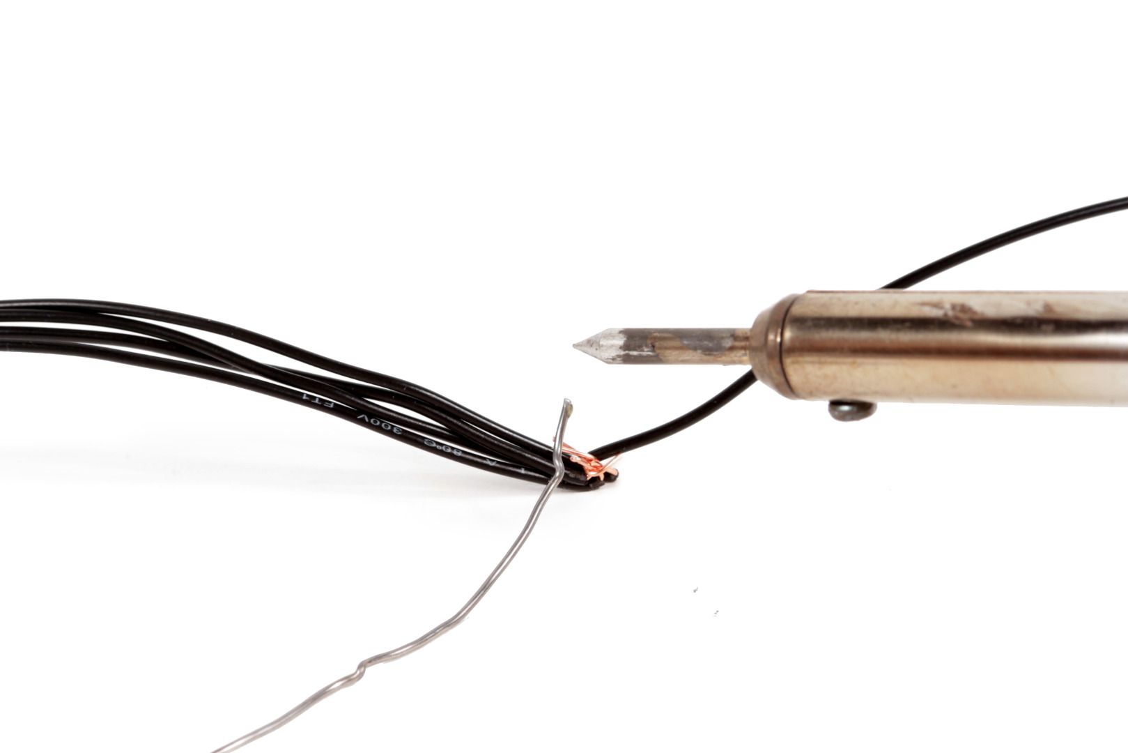

Step 13: Power and Ground Wires
In our circuit the 6V power connection needs to be split three ways and the ground connection needs to be split four ways.

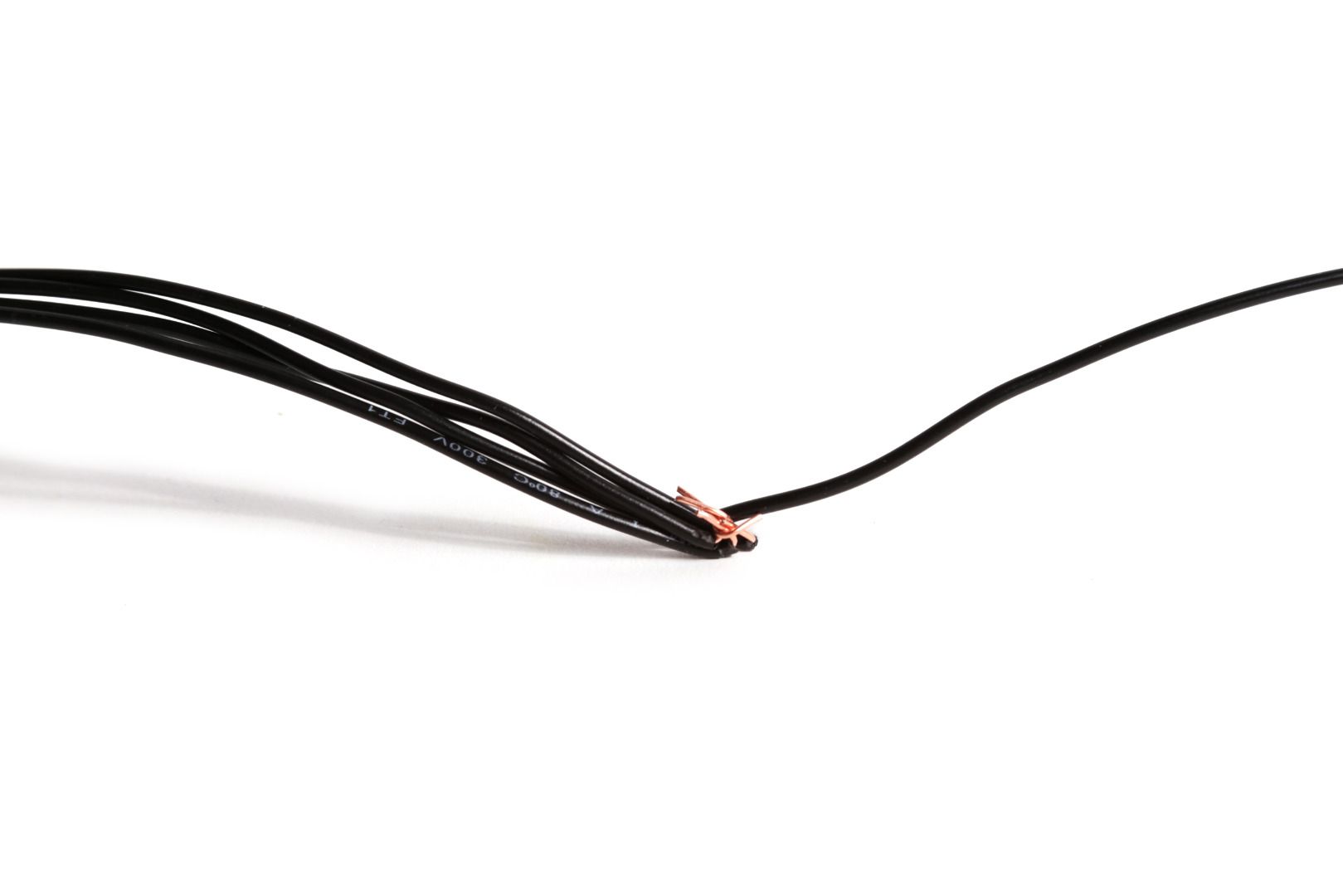

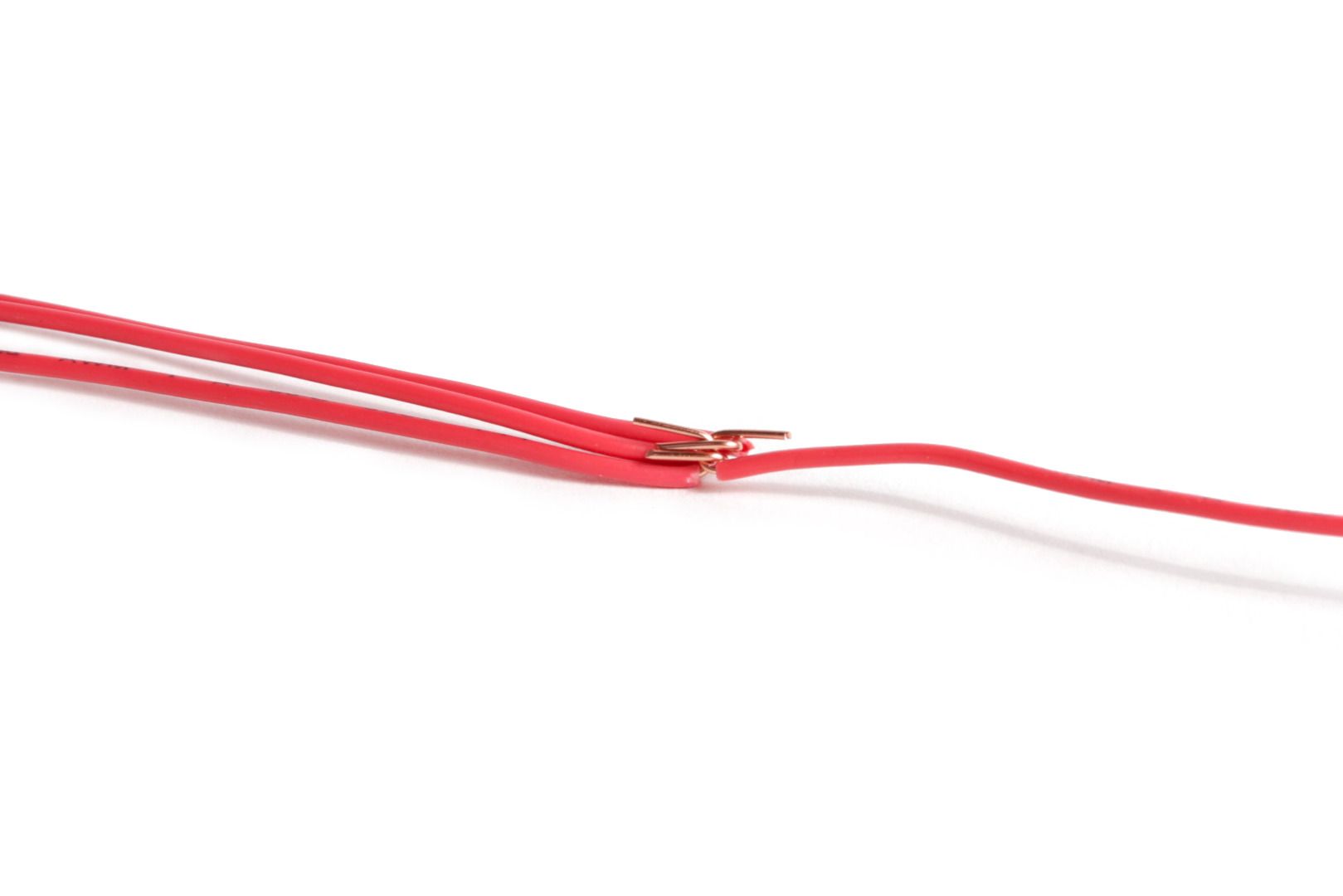

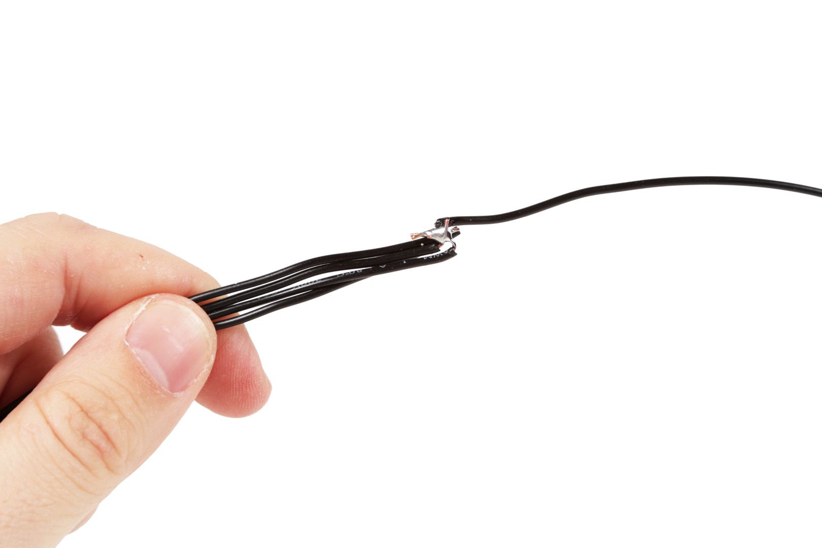

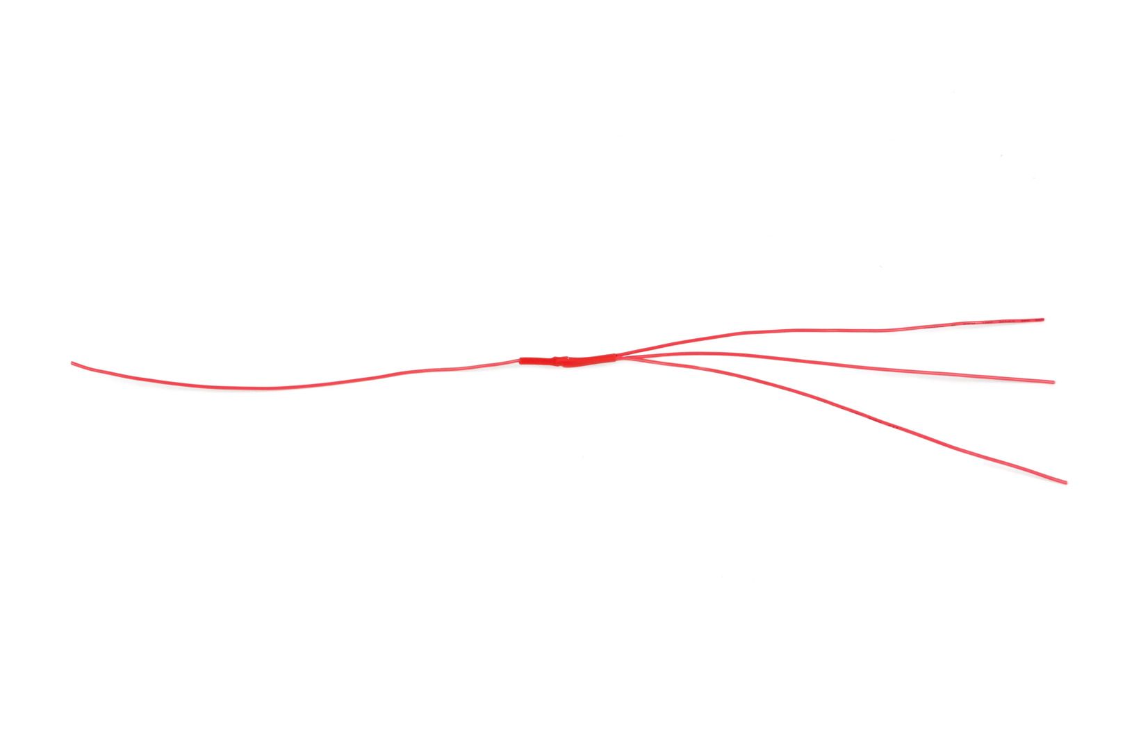

To do this, we will solder three solid core red wires to a single solid core red wire.

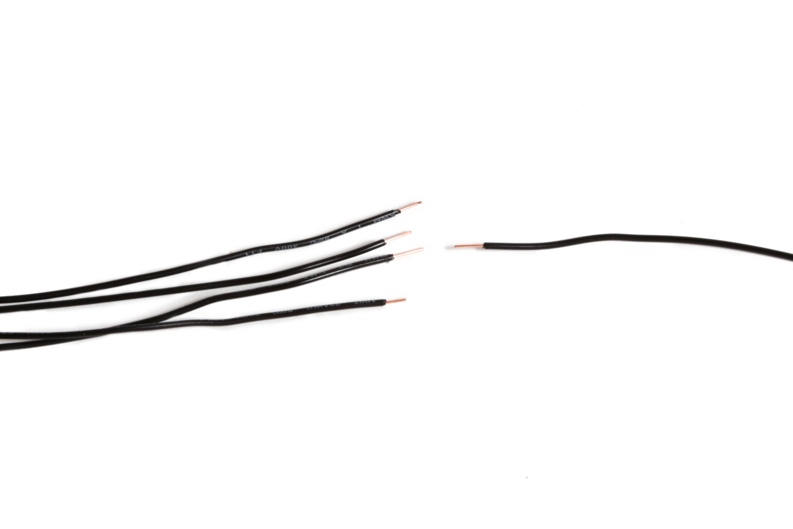

We will also solder a solid core black wire to four solid core black wires.
We are using solid core wire because they largely need to plug into servo sockets.
To begin, cut the appropriate number of wires, and strip a little bit of insulation of one end of each.

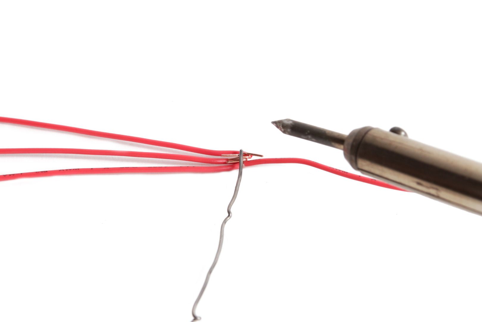

Twist together the ends of the wires.
Solder this connection.

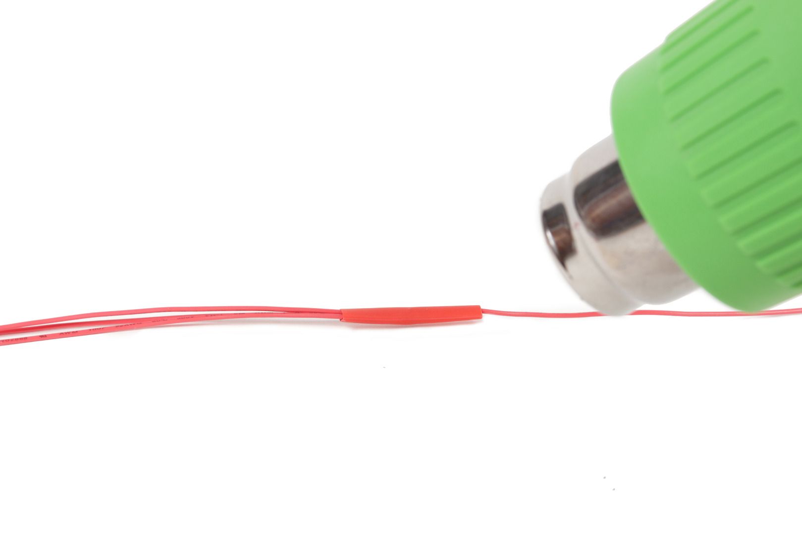

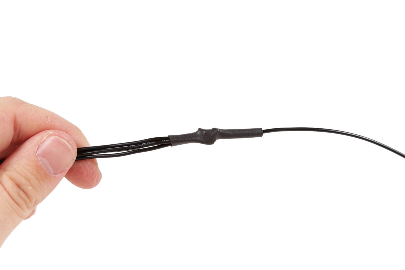

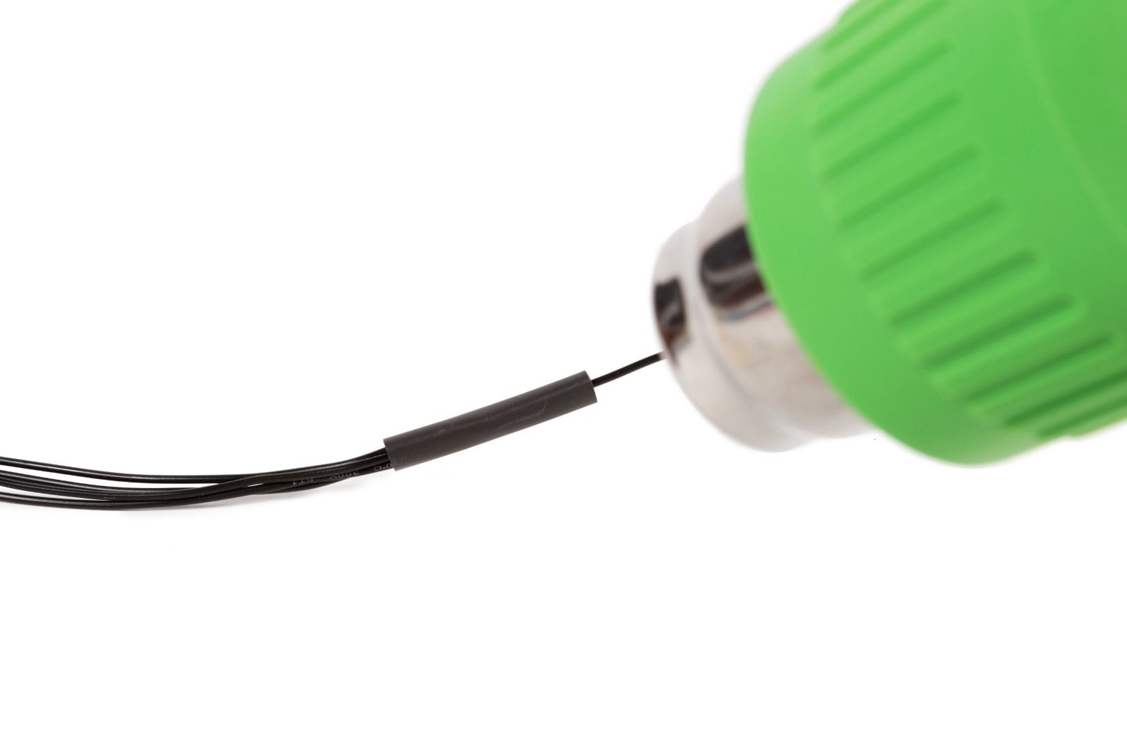

Finally, slip a piece of shrink tube over the connection and melt it into place to insulate it.
You've now soldered two wiring harnesses.
