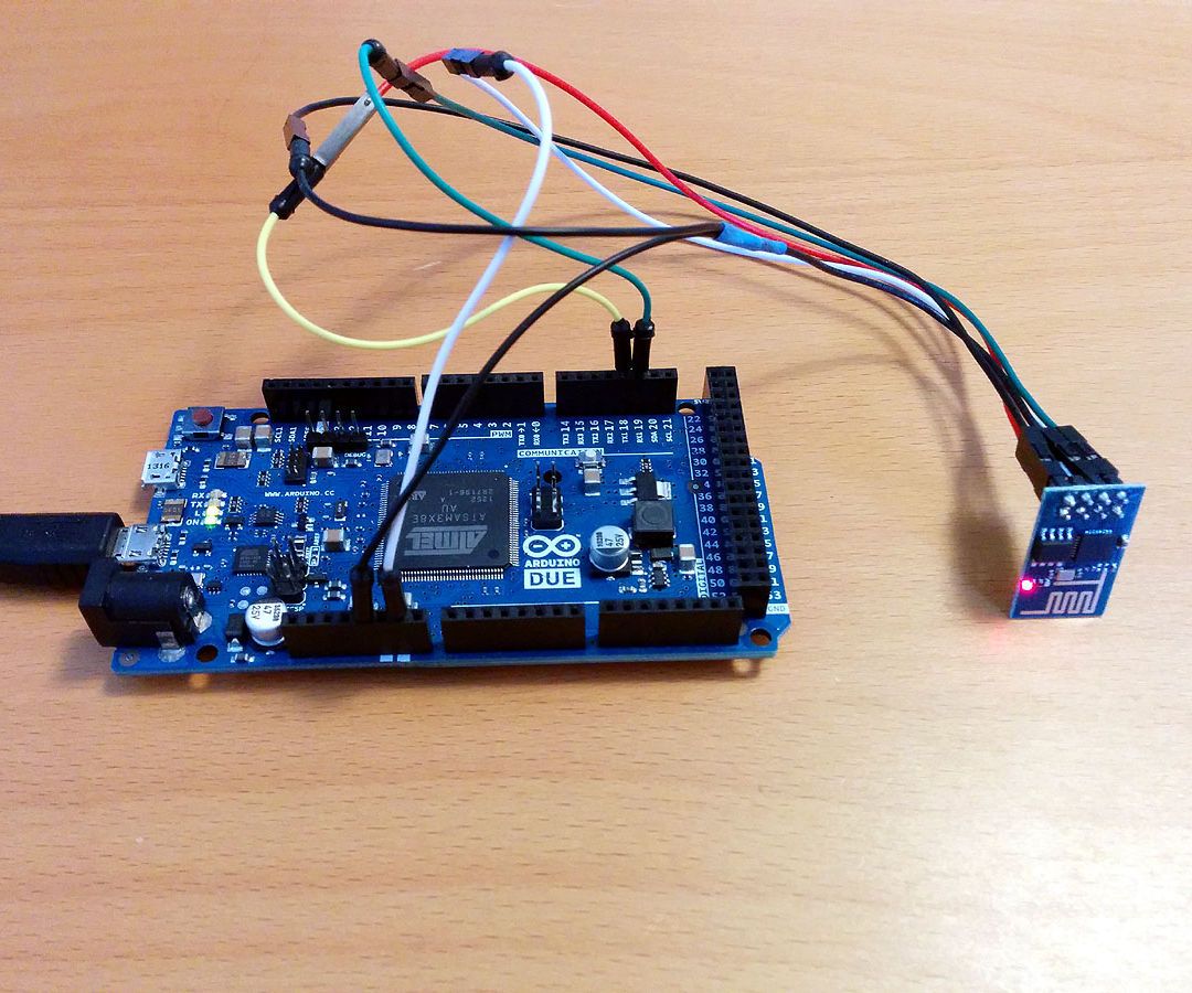

Step 2: Wiring
The wiring is very simple. You have a TOP VIEW diagram here that shows you how to do it. To be more specific you need to do three connections:
  • DS18B20 - Vcc Pin ---> HUZZAH ESP8266 - 3V Pin
  • DS18B20 - GND Pin ---> HUZZAH ESP8266 - GND
  • DS18B20 - Data Pin ---> HUZZAH ESP8266 - #4 Pin
To be able to program it you need to connect as the programming cable too. If you use the Adafruit cable I recommend then you just plug it in with the black wire to the GND pin as shown in the picture above. For more details how to program HUZZAH board with Arduino please go to Adafruit website.

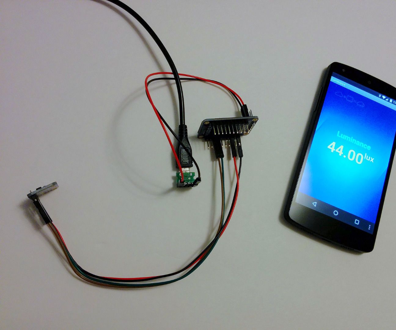

Step 8: Using the Temperature Monitor
Open the mobile application you have created and you are gong to get a screen like the one above.
Here you can see your temperature from the sensor and the current threshold.
You can change the temperature threshold by using the slider.
Whenever temperature goes under threshold the system will send you an email.
