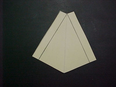

Step 4: Back to One... With Fins!
Take bottle one (the intact bottle) and mark three vertical lines on the bottle even widths apart. These will be the place-markings where your air dynamic fins go.
For the fins: Take one manilla folder and make a right angle along the folded edge (as diagramed below) and add a rectangle to the top of the triangle (opposite side of the folded edge). Do the same thing on the other two folders.
The measurements of the triangle should be Folded Edge 7" single lined side (side above the scissors in the picture) should be 5" (4" for the side and 1" for the folded edge) . The last side should be about 5.5".
Attach the fins over the lines, using the folded lines as supports and tape down the folded tabs.
