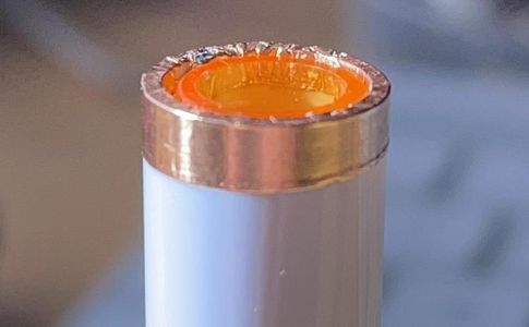

Step 3: Making Candles With DIY Pogo Connectors
I have taken pictures for better understanding.
Although the surface of these magnets are well solderable, unfortunately because of Curie point these neodymium magnets are not solderable. They loose their magnetic power entirely around 200 celsius degree.This trick is to save magnets against the heat shock.
