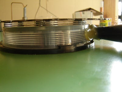

Step 1: Start With the Basic Tesla CD Turbine
See my previous Instructable on building the basic Tesla Cd Turbine, (see picture below)

Step 3: Make the CD Turbine Disc Pack
Assemble Disc Pack :
Working with a CD Spindle and your favourite useless CD's, open Spindle Cover and remove CD's from the Spindle. Crazy-glue six 5/16 inch x 1/32 inch neodymium disc magnets in appropriate locations, evenly spaced at edges on one CD, as in the picture.
Use a piece of medium sandpaper to rough up both the surface of the CD where the magnet will sit, and also roughen the mounting surfaces of each of the magnets. Use only a tiny drop of superglue for each magnet.
Flip over CD and carefully glue six more magnets onto CD to correspond with previously glued magnets on the other side. They will tend to pop into place at the correct locations "automagically". Make sure they don't overlap the edge of the disc.
Now put this first CD onto the Spindle of the CD Case. Put a small drop of glue on each magnet, and place another CD on top of the first. Glue on 6 more magnets to that CD. Put small drops of glue on the magnets. Place another CD on top of them. Continue in this manner until you build up a CD disc pack with 8 discs using 60 magnets.

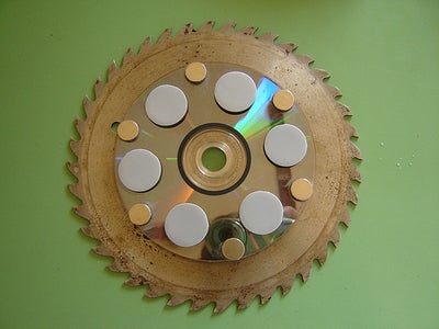

Step 6: Make a Magnetic Coupler
Now you need to make a Magnetic Coupler to enjoy getting useful energy out of the Tesla Turbine device. We'll use the same technique as the CD Disc Pack.
Start by placing a CD on top of the previously made CD Disc Pack. Line it up with the other CD's. Next, place a small drop of glue lined up to a magnet point on the CD. Take a 1/2 inch x 1/8 inch neodymium disc magnet and place it at the magnet point, on the glue. It will self-position quickly; just be sure not to let it hang over the edge of the CD as the glue sets.
Repeat at the other 5 magnet points, so that you end up with a CD with six magnets glued to it. Flip it over and glue on six 3/8 x 1/32 inch disc magnets, allowing them to attract and align with the previous six magnets. Again, be sure magnets don't overlap the edge of the CD as the glue sets.
Place this 12-magnet CD on the CD spindle to keep things lined up, then put a small drop of superglue on each of the the six visible magnets. Place a CD on top of this and glue it to the magnets. Glue on six more 3/8x 1/32 magnets, and then another CD. Glue on 6 more magnets, this time use the 1/2 inch x 1/8 inch magnets.
By now you have a 3-disc pack with magnets on both sides. This is the Magnetic Coupler. I added some stick-on Teflon pads to the Turbine side for smooth running,
Be sure the North-South polarity is the same for each glued magnet. In other words, you should end up with all south poles on one side of this Magnetic Coupler and all north on the other, similar to the CD Disc Pack previous.
The Magnetic Coupler should tend to repel the magnets in the CD Disc Pack, when placed at the top of the CD case.
You can order the BEST neodymium super-magnets from K&J Magnetics here.

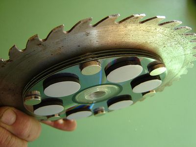

Step 7: Skilsaw Attachment
The Skilsaw Blade Attachment" is very dangerous to actually use, but it demonstrates the power and versatility of the Tesla CD Turbine. Other attachments, implements, or tools are readily adapted instead of the Skilsaw Blade. For example, an auto alternator could be adapted, which will be the topic of a new Instructable.
The basic idea of the Skilsaw Blade Attachment is to use the Magnetic Coupler to magnetically clamp on the blade, while keeping it lined up at the centre hole. It is preferable to put a cut-off 5/8 " bolt or pin in the centre to keep the blade centered at high speeds. (any off-center wobble would be sheer disaster!)
That's it...the blade just clamps on magnetically to the Magnetic Coupler. The Magnetic Coupler just rides on the top of the CD case, while engaging the magnets in the CDCase. Scared enough yet??
Well, ok, I did originally test run the blade without a guard and without a shaft to hold the blade on; I lived through it, I won't do that again! My new setup is much more robust, with little or no possibility of blade fly-off. There is both a guard, and a stationary shaft attached to a screwed-in plate. It all worked really well during the PumpkinCuttin Ceremony, other than the guard got plugged up with pumpkin guts and slowed the blade down!

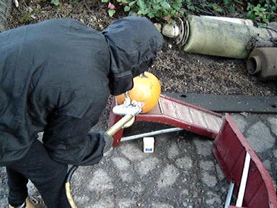

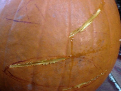

Step 14: Pumpkin Cuttin' Ceremony
Did the thing really work?? The machine performed reasonably well, and the PUMPKIN ACTUALLY GOT CUT.
More importantly, I DIDN'T get cut and actually felt reasonably safe with this new design.
