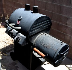

As far as wood smokers go, you'll find there are three kinds: cabinets, horizontal drums, and vertical drums. I personally use a humble horizontal drum with an offset smoke box -- I like having the wood and the meat in different areas; it just makes my brain happy to have things organized like that -- but the vertical drum smokers are very popular. I won't go into too much detail here, because I'm sure it's not why most of you are reading this. This is a great page detailing the choices that are out there. Now that we have that out of the way, we can get down to the meat of this problem.
