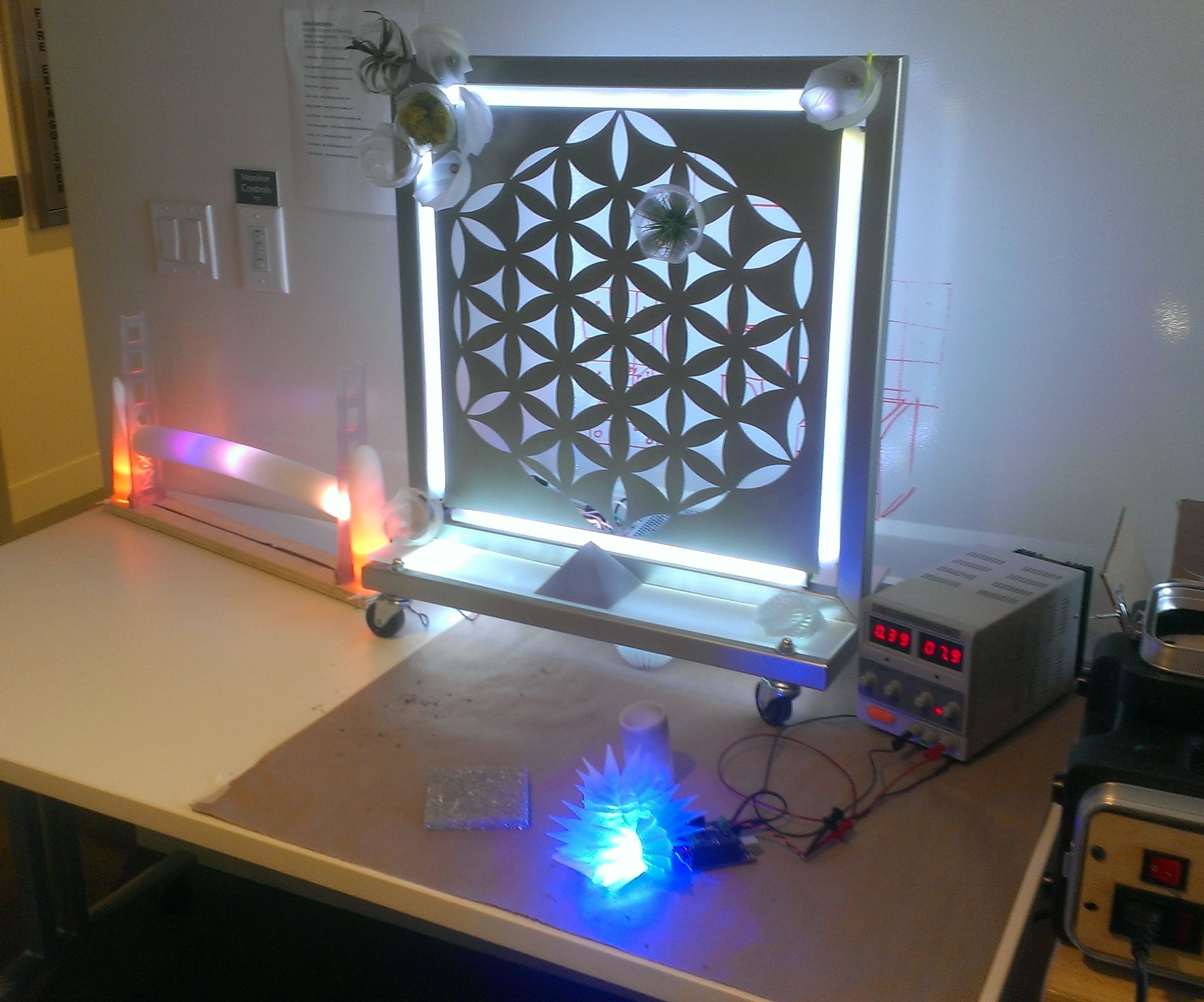

Once the building flashed green lights when I keyed my ID card and tried to use a tools, I began prototyping. Starting by laser cutting a cardboard frame of the wall, then taping it together to get a sense of proportions. Next was a plywood frame with wheels, all good here. Lastly I committed by cutting 1.5” square tube steel and welding the frame together (with a little expert guidance from Sean, the sheet metal alchemist).
Cutting the Flower of Life
I managed to craft a mostly stable cut path for the FoL design so the 64 pieces would sit long enough to be rescued or politely tumble under the foamy water to the bottom of the bed. Prepping the OMAX water jet is always fun with the 4’ x 10’ cutting bed. The supports are pirhana like and the water appears highly suspect. My cut took about an hour, created 64 pieces (slight peril) and used 40 pounds of aggregate. Pretty darn cool - well, until a piece deflects the stream of 50k psi water briefly. I may be the first person to splash the overpass 10’ above the water jet and I will not be the last, as the glass walls of the catwalk tell me someone saw this coming ;)

Pulling a few late nights brought the lighting in line with mvp. The wall was getting internal color, traffic was crossing the bridge in the fog and the uprights faded GGB International Orange in and out. Using arduino and LumiGeek shields from Parts, I powered / controlled three types of RGB LEDs - 1 Watt / heat sink, addressable and non-addressable strips. These accented the 3D printed pots, steel frame /design and uplit the bridge with headlight/taillight comets emulating cars in the fog.
