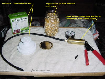

Step 1: Acquire the Necessary Tools.
You'll need:

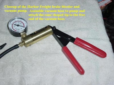

1) A brake bleeder/vacuum pump from Harbor Freight (cost=$19.99).
2) A Tila FoodSaver mason jar adapter (I bought mine from Bass Pro Shop for $9.99).
3) A clean empty mason jar with a new lid. You can get these from WalMart or some grocery or hardware stores. Or ask your grandmother for one.

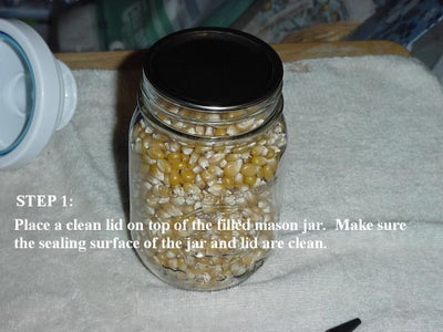

Step 3: Seal the Jar.

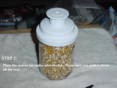

Place a clean mason jar lid on the jar. Make sure the sealing surface is clean and dry. For this step, use the flat lid only and not the threaded ring. Place the FoodSaver mason jar sealer over the top of the jar and lid and push down to make sure it is completely and evenly seated.
Step 4: Evacuate the Air.

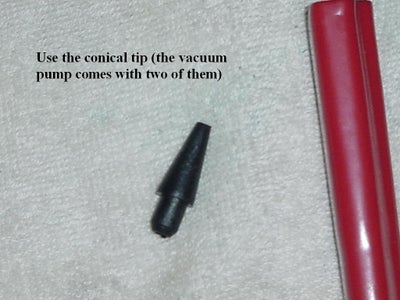

Press the conical tip of the vacuum pump into the hole in the mason jar sealer (be sure to press hard!). Pump the brake bleeder and watch the gauge. Pump until you have at least 20 inHg vacuum (the higher the reading, the higher the vacuum). When you have a good vacuum pulled, quickly pull the vacuum tip out of the hole, then remove the jar sealer attachment from the jar. That's it! The jar should be vacuum sealed!
