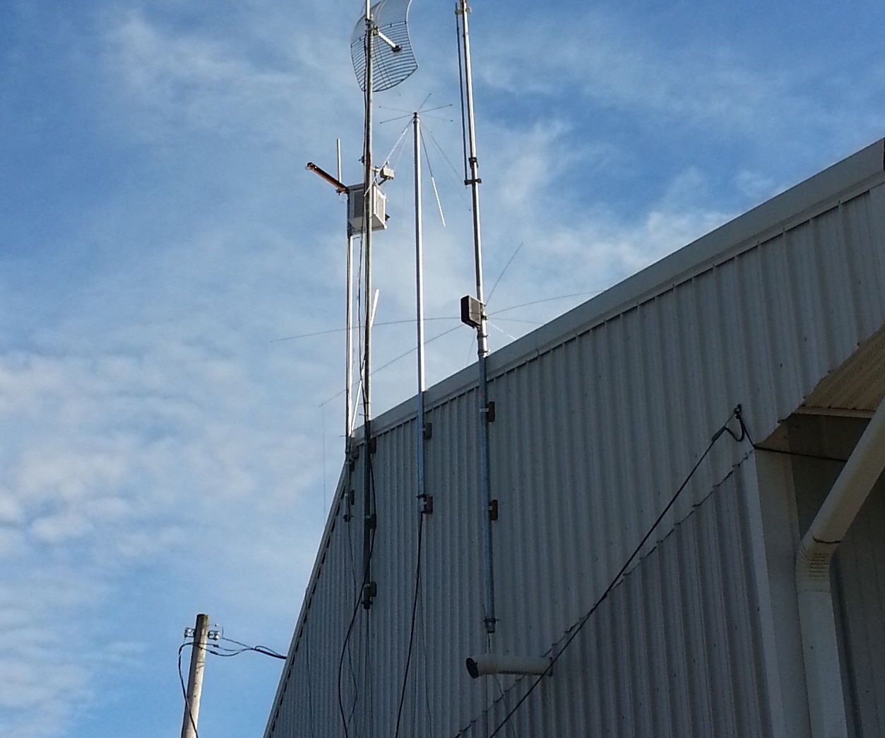

So what is a gin pole you may ask? And why would you want to build one? It's a temporary hoist that attaches to the top of a tower. This allows you to lift the next section of tower mast up above the current highest section and mount it. Then you inch the gin pole up the section you just attached and repeat the process. You use it the in reverse to disassemble a tower. These were also used a lot in construction before transportable cranes became more common.
Why would you want one? Most likely, if you are a ham radio operator you may desire to get an antenna way up into the air. Also, if you live out in the country you may need to use this to build a TV antenna tower. Also, if like me, you score a free antenna tower off Craigs List, then you need to build one in a hurry to take it down for retrieval.
There are two types of antenna towers: brackated and self-supporting. Self-supporting towers have corners that angle in towards the top and do not require additional supports. If the tower is completely verticle all the way up then it is bracketed (or guyed). Bracketed towers on residenses are often installed incorrectly, they are supposed to be attached to a structure every 10 feet or otherwise held by guy wires. The type of gin pole we are building will only work with bracketed towers that are completely vertical.
This is not designed to lift people, only sections of antenna tower. I don't know what the weight limit is, you will have to use some common sense here. Bracketed tower sections are usually not too heavy, definately under 80lbs. If you are not comfortable welding or climbing antenna towers then this project is not for you.
