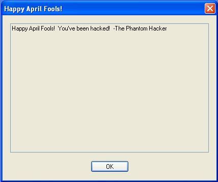

I have noticed that most of the pranks on this site are on the extreme side, but what if you just want to use a prank that isn't so extreme? Well, this instructable is for you! Please note that this version only works on Vista and Windows 7. The XP version can be found here.
I will be using a .vbs file to display three messages a certain number of times when the computer starts. The first message is "Happy April Fools! You've been pranked!". The next one says "I bet I can be very annoying!". The last one says "Guess what? You have to put up with these messages (however many more times based on whatever you set) more times."
Once it is done, it will tell the person you pranked how to remove it.
