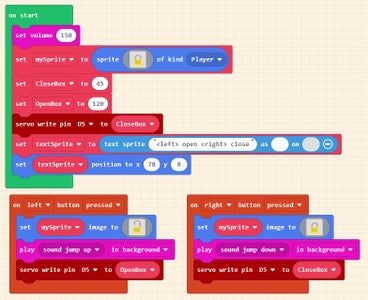

Instructions on using MakeCode Arcade with your PyBadge are beyond the scope of this instructable but there is an excellent step-by-step tutorial on the Adafruit website to get you oriented. For building and testing your Asobimasu box, you will be using the simple lock program located here. This code is also a simple example that will allow you to modify any MakeCode Arcade game to control your Asobimasu Box. Load this code into MakeCode Arcade at https://arcade.makecode.com/S17496-47639-73924-68601 and download it into your PyBadge.
You can also directly download code that can be dragged and dropped into your PyBadge at:
https://github.com/reachandteach1/makecode/raw/main/arcade-simple-lock-2.uf2
After you load your code onto the board, you should see the lock graphic on the LCD screen as shown. The left and right arrow buttons on the PyBadge will unlock (left button) and lock (right button). If everything is working, you should see and hear the servo move as you push the left/right buttons. Servo commands are output to port D5 on the PyBadge board.
I've included a screenshot of the code for the simple lock. You can see that it is pretty easy and straightforward. It will require you to load the Feather (Adafruit feather pinout) extension if you are creating this code from scratch. You can find that as a standard extension under the Extensions menu.
We will later install a more interesting puzzle into your PyBadge but the Simple Lock code will continue to be helpful as you build and test your box.

You can also modify any existing MakeCode Arcade game to open and close the Asobimasu Box. You can use the sample code screen shot in Step 2 as a guide. Very briefly:
- Add the Feather extension to the game code.
- Create and set two variables in the on start block: CloseBox=45 and OpenBox=120
- Add the command "servo write pin D5 to CloseBox" to the on start block
- Add the command "servo write pin D5 to OpenBox" in the game code right before the "game over WIN" instruction
