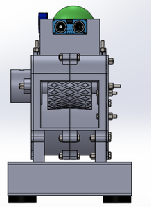

Step 3: High-Level Design
Here, we describe all subsystems and how they are connected and communicate with each other:

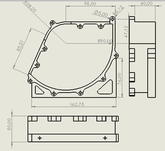

1-Main part:
The main part is composed of two parts. In this part, it’s where the compression of ball will happen and will follow the trajectory of the part to be launched then. The design considerations for this part are the main essential element to fulfill the requirements of the project. It was designed to be small in size and in the same time can launch the ball to a distance of 10 m. Therefore, the trajectory that the ball will follow was designed to be circular path, the compression of the ball happens in the top part of the trajectory then the ball continue to be launched without compression. However, the part needed to have holes in order to add the bolts and nuts and tightening them. Also, the part has a space in the top to insert the ball and space in the front which need to be big enough to allow the ball to be launched freely.

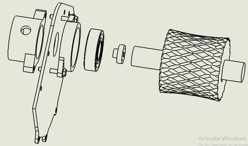

2- Wheel:
The wheel is the part that will rotate and compress the ball in the initial stage. Therefore, some design considerations were taken into account. First, the wheel has to be big enough to compress the ball and give it enough torque to be launched far enough. Second, to avoid slipping between the ball and the wheel, the team thought of giving the wheel surface a geometry that has a high friction with the ball. The concept was something like knurling which is basically a pattern of crossed lines cut from the surface of the wheel.
3-Shaft:
The shaft is the element that connects the wheel with motor. The design considerations are therefore very important to ensure a smooth running of the machine. First, the shaft needed to be strong enough to withstand the compression force from the ball. Second, the shaft size needed to be consistent with the size of the bearings available. Third, the shaft should contain a square key to block the rotation of the wheel inside the shaft. However, for the axial motion of the wheel it was blocked by using superglue in the interface of the wheel and the shaft and therefore combining them in one part.
4- Coupling:
After we have coupled the shaft with wheel, we need to couple the shaft with motor. But, prior to that we need to ensure the stability of the shaft by adding bearings on both sides of the shaft. However, in order to couple the shaft with motor we used a flanged shaft coupler suitable with the motor shaft diameter. The shaft coupler was screwed into the shaft which has already holes for that in order to avoid eccentricity. Also, the motor used needed to be attached on the part in order to couple it with the shaft, therefore a new part was introduced whose main goal is to hold the motor on place on the side of the main part with the same on the same bolts that are used to hold the bearing, in that case we ensured centricity of the shaft, the coupling and the motor. After that, the motor was coupled with shaft and when we tested it showed good stability and durability to compression.

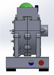

5-Container:
In order to lock the ball before launching it, we needed to introduce a mechanism that could lock the ball and that allows the sensor to detect the presence of the ball. Also, since we needed an ultrasonic sensor to detect if someone is in front of the ball. We thought of using one part that can combine the three elements together. Therefore, the design considerations for this part are adequate size for the ball and a place to put the servo motor and the sensors.
When the motor will be running, it was expected that there will vibrations that might cause instability of the part. In the same time, we needed to have a place to put all the electronic components inside to make the robot more beautiful. Therefore, this part needed to have a size that can contain the electronic components and ensure stability during the running time of the motor. Rubber feet where used at the bottom of the base to increase the friction with the ground in order to avoid slipping, in the same time the rubber feet provide some vibration dampening caused by the motor.
Step 4: Mechanical System (manufacturing Choices)
In the design process, we decided to use 3d printing for some parts (where the material is PLA) and laser cutting for others (where the material is wood). Since the 3d printers have a limited printing size and time, this was taken into account in the design of the main part. Therefore, the main part was split into two parts so we can print each part in alone and then joining them together. By that, we could save time and reduce the risk of printing the part all over again if anything went wrong. Also, we decided to use laser cutting instead of 3d printing for some parts that are constant in thickness like the covers of the base and the main part. However, since we have a vibration source in the model which is the motor, we were limited to the use of laser cutting to avoid joints loses that could lead to less rigidity of the part.
All the CAD files can be found at the end of this report.

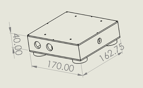

Step 5: Circuitry & Sensors
The ball launcher needs different electrical and electronic components to work. The electronic part is a very important point of our prototype because it is this which will take care, thanks to an Arduino, of being able to control our system so that each part works so that our prototype works and fulfills the desired function. It was thus necessary to find the various electronic components the most optimized and the least expensive.
The device needs a motor to accelerate the ball and different sensors, drivers and microcontrollers to control its operation. In addition, power supplies are also needed to power the various components.

To assemble the prototype, first step is to print the two main pieces of the prototype and to laser cut the two wood plane. The next step is the connection between the wheel and the motor, first, the ball bearing needs to be fixed on the wood plane. The shaft coupler, the shaft and the wheel must be put together. Finally, the motor should be screwed on its support, the shaft of the motor is connected to the shaft coupler.
The two wood plane must be screwed on the two main printed pieces (height hours of printing for each part) and the two main printed pieces must be screwed together with the assembly between them. The box that is going to keep the ball (2 hours of 3d printing) is then attached on the top of the previous assembly using screws. Up to here, the screws used are all the same (flat head M4 x 25 mm). The ultrasonic sensor, servo motor and infrared sensor are all added on this box using smaller screws (1 millimeter diameter). To contain additional electronics such as Arduino, battery, motor driver and step up voltage device, an additional box is added to the prototype, the side of the box must first be printed (four hour of printing), the top and the bottom is made from wood laser cutting. The additional electronics are glued on the bottom plate using double sided tape (withdrawable). Rubber foot are also added with screws. Before closing the box with the top wood plane, the cables between electronics motor and sensors must be soldered. The electronic box is screwed with the bottom of the final prototype
