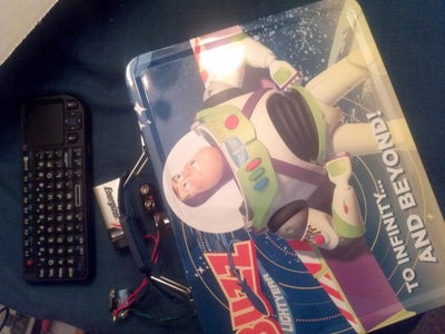

The Deck works equally well on systems with a 7" ULCD7 touchscreen or with an external monitor/TV via the BeagleBoard-xM HDMI or S-video port. My personal setup consists of a BB-xM with the ULCD7 mounted in a Buzz Lightyear lunchbox, a second BB-xM without a display, and a BeagleBone. I connect them together with a USB-powered network hub. I also have 2 Alfa wifi adapters and a directional antenna for wifi hacking.

6. A presenter keyboard/mouse combo. I like the Favi unit which you can get for about $25 from Amazon or other retailers.
7. Optional: If you want a small power supply you can make one with the following: 2 9V battery clips, a 7805 voltage regulator, a small capacitor (100 uF is probably good), a 2.1 by 5.5 mm barrel plug, and a few pennies to use as a heat sink. Note that this can be used to power the device without a touchscreen. The touchscreen sucks a lot of power and I'm not responsible for any fires you start trying to run it off this power supply. You can also use any combination of batteries that are above 6V, including rechargeables.
