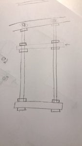

The images above show some of the early conceptual drawings we used for the Duvel robot.
The aim of this project is to design a robot which is able to raise a glass and a bottle to predefined required positions/angles in order to pour beer from a bottle to a glass. For easier accomplishment of the project the goal of this project were subdivided into several steps listed below:
  1. Raise the glass to a required height and maintain its position.
  2. Raise the bottle to a required height and maintain its position.
  3. Pour beer into the glass
  4. Lower the glass to it’s fixed position.
  5. Lower the bottle to it’s initial position.
The execution of these tasks are dependant on the mechanical and the electronics part. The mechanical design require to take into account:
  1. How will the elevation be done? The easiest way to go is by rotation, as it is the case when pouring beer. The tip of the bottle remaining at it’s position the bottom raise, creates the downward flow of fluid. Rotation motion has to be powered with motors, which means that shafts are required. To decrease the amount of torque whitheld by a shaft, it is better to use a motor per rotation motion.
  2. How will the bottle and glass be held ?The bottle needs to be fixed during elevation, and be raised without falling or slipping.
The overall has to be fixed into a solid, rigid structure, while allowing it s rotation. Several connections will be designed(shaft to holders, shafts to servo) to connect each parts of the design.

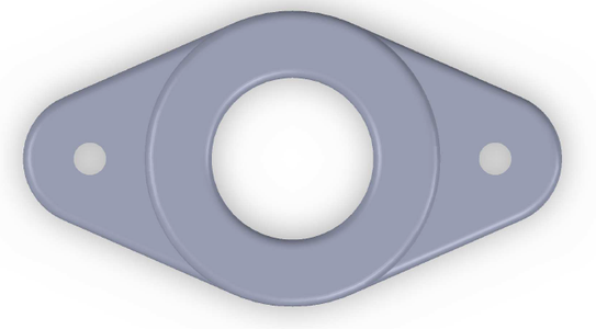

Connections
All connections are 3D printed in PLA.

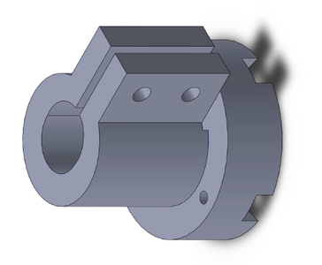

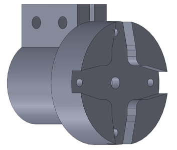

  • Shaft to holders: The same configuration were used for both holders. a rectangular shape block with a 9.8 mm hole and four bolts holds for fixations. It consists of two pieces held together by bolts, whose fastening increases the clamping of the holder to the shaft.
  • Shaft to motor: It is generally called a coupler, it is designed as a cylinder which can hold and clamp tightly the shaft halfway through the cylinder. The part of thebase of the cylinder is connecting the shaft to the motor. The base which has holes designed after the servo horn, where the horn fits perfectly. This is accompanied with holes that are pierced and are used for the fastening of the horn to the coupler.

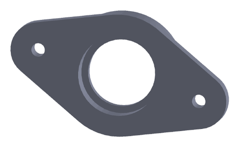

  • Ball bearing mount: A 2 bolts ball bearing mount is designed of ID 10.2mm. The mounts are fixed on the base structure. The ball bearing is prevented from falling or slipping at the upper and lower surfaces of the mount. The mount is designed for the shaft to fit tightly inside, the ball bearing is fixed in it’s position and doesn’t slide or slip.

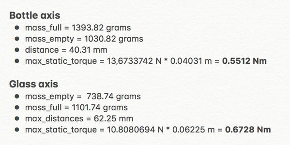

Torque measurement
To find the right motor for the filling process, the maximum torque is necessary. Here the approach used is that if the mass of the bottle holder is known, the weight can be deduced using the following formula:
Weight = Mass * Gravity acceleration
Then the torque can be also deduced by multiplying the weight by the distance that separates the center of mass of the holder to the axis of rotation.
But to have a better accuracy on the result, the maximum torque is compute on Solidworks. This software considers the influence of the whole structure, to compute the maximum torque. The results are following: Torque calculations

The servo and the shaft.
The shaft and the servo can be easily joined together, thanks to the 3D printed shaft coupler. The following figure illustrates how to do it in practice.

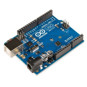

The brain – Microcontroller
The processing power of the Duvel Robot can be supplied by either a Raspberry Pi or an Arduino board. The task we have to accomplish being very simple and repetitive, we decided to use the simple Arduino Uno.
SEE ARDUINO PIC (1)

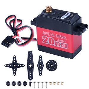

The muscles – Motors
We need to rotate both the glass and the bottle holders to specific angles to perform a foamless filling. To do this, two solutions could be used: servomotors or DC motors with encoder. Since the required torque is not to high, we chose a high torque hobby servomotor: the LewanSoul LD-20MG.
SEE SERVO PIC (2)
This servomotor has the following characteristics:
  • Weight: 65g(2.32OZ)
  • Dimension: 1.57*0.78*1.59inch
  • Speed: 0.16sec/60°(7.4V)
  • Torque: 20 kg·cm (277.6 oz/in) @6.6V
  • Accuracy: 0.3°
  • Working Voltage: 6-7.4V
  • Min Working Current: 1-1.5A
  • No-load Current: 100mA
We can see that this servo has a stall torque of 20 kg·cm, which corresponds to 1.96 Nm, which is more than two times the max needed torque (0.67 Nm). Such a high torque comes with some disadvantages: the servo box is a little larger than standard hobby servos, and it draws electricity at at least 6V and 1A when functioning.

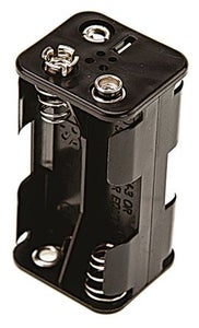

The lungs – Power supply

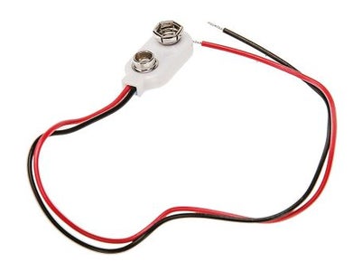

Since the two servomotors require between 1A and 1.5A each, we need an additional power supply. 4 AA rechargeable batteries can be used and linked in series with a battery holder and a connector in order to get a 6V power supply.
SEE BATTERY HOLDER PIC (3)
SEE BATTERY CONNECTOR PIC (4)
Of course, the Arduino Uno board must also be powered. For that matter, a simple USB-B to USB-A and an USB-A power adapter can be used.

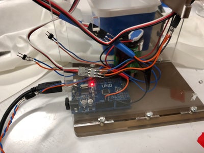

Phase 2 – Protoboard or soldered cables
Once all components have been tested (see next step), it's time to make a protoboard, i.e. a prototype PCB of our electronics assembly. The idea is to compactly solder all components together on a board that can be stacked on the Arduino.
Filename: Duvel-Protoboard.fzz
SEE PROTOBOARD SCHEMATIC (9)
On the Duvel Robot however, all components are placed away from the Arduino: the servos are attached to their respective shafts, the switches are attached to different parts of the structure and the battery pack must be amovible so batteries can be easily charged. For this reason, another approach can be used: ditch the protoboard and replace it by cables only. In our case, the protoboard would indeed only serve as a connection between all components.
SEE SOLDERED CABLES PIC (10)

The setup function enables the Serial communication, and links the 3 switches, the LED and the servos to their associated pins.
void setup() {
  Serial.begin(9600);
  printMessage("Starting experiment!");
  pinMode(glassButtonPin, INPUT);
  pinMode(bottleButtonPin, INPUT);
  pinMode(powerButtonPin, INPUT);
  pinMode(ledPin, OUTPUT);
  glassServo.attach(glassServoPin);
  bottleServo.attach(bottleServoPin);
  printMessage("Setup finished!");

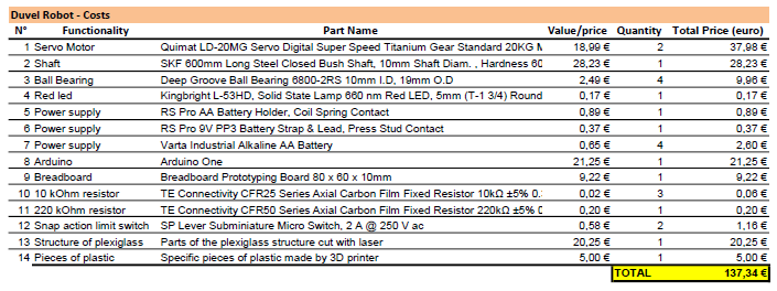

Cost breakdown
In this part of the tutorial, a table appears where there are gathered all the components that are used in the project and his respective cost:
SEE COST TABLE
It is necessary to explain some aspects in the calculation of the price of some components.
In first twelve components, the price that appears is the unitary price of every component multiplied by the number of used components. But, the components 13 (Structure of plexiglass) and 14 (Pieces of plastic), are calculated in a different way. These components have been obtained by laser cutting and 3D printing, as it explains in this tutorial. For this reason, to calculate the price of these components, it is necessary to calculate the price of the base material.
In case of the structure of plexiglass, as it is commented in this tutorial, the pieces are obtained cutting with laser a plate of plexiglass. For this project, 0,45 m2 were used of plexiglass and the price of the plexiglass is 45 €/m2. In conclusion, the final price is 20,25 €.
In case of the pieces of plastic, as it is commented in this tutorial, the pieces are done by a printer 3D that uses a roll of thread of plastic. The price of 1 roll of 1 Kg is of 20 €. The pieces that have been printed, approximately, weigh 250 g. Therefore, the final price of the pieces printed is of 5 €.

The shaft couplers which didn’t clamp the shaft very well. This is because the
inner surface was smooth (PLA material used for the 3D print), and the shaft also. So, we start first by reducing the inner diameter, it doesn’t work. We add then a tape to have a better friction, that also didn’t work due to the high weight and torque necessary. So finally, we glue the shaft and the coupler with epoxy and it works.
The axis had another problem. The problem was that the dimension of the diameter along the length was not constant, was changing slightly. This was doing that depending on what part of the axis was in use, the bearings were fitting well or not. To place in the correct position the bearings that were not fitting good, we had to use lubricant and the force. But another problem appeared. Since we use the force, there was danger of which some piece was breaking. Ultimately, this happened. Due to the great force that we had to do to place the bearings, some pieces broke and we had to return to make them.
The selection of the servomotors was another problem. The first thing that we did, was to calculate the static torque that would have the project. With the result that we obtained, we did the selection of the servomotors that we were going to use and bought them. When the servomotors came, we tested and verified that they did not have the necessary force. We re-did the calculations and realized that we had to use the dynamic torque to select the servomotors. We had to buy new others and these yes that worked.

To improve the electronics and the appearance of the project, we might design a real PCB in which we would weld the different components. A LCD to be able to monitor and control the robot would be another possible improvement that might be done.
The connections between the servomotors and the axes it is different of the things might be improved. The problem is not the design of the piece, but the connection between the piece and the axis. Due to the smooth finish of the axis and the plastic 3d printed pieces, the surfaces slip. To improve it, we might have designed the piece of connection with some cracks and have added to the axes wedges to achieve a mechanical connection.
