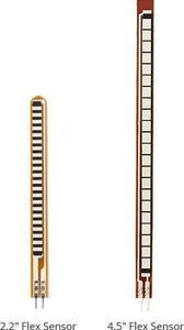

Step 2: Flex Sensor
A flexible sensor, also known as a bending sensor, is a sensor designed to measure the amount of bending. In fact, a flex sensor is basically a resistor whose resistance value changes upon bending. Since the resistance value is directly proportional to the amount of bending, it can also be called a Flexible Potentiometer.
Flex sensors are generally available in two sizes: one is 2.2″ and another is 4.5″ long. In this project, flexible sensors with a length of 4.5″ (11.4cm) were used. Of course, you can also use 2.2″ (5.5cm) long flexible sensors, it will not affect the project circuit.
Adafruit Long Flex sensor - https://amzn.to/3mAgQXh
For more technical details see: https://lastminuteengineers.com/flex-sensor-arduino-tutorial/
