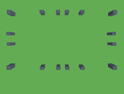

Step 2: Make the Main 4 Pillars on the Corners.
Take another square, make the dimensions to 3.0 x 3.0, x 30.0 for height. (LxWxH)
Set the color to grey.
First, place one in one corner, copy it, paste one, move it so that it has the exact same location as the original one. Then, arrange so that it forms a line like it does in the image. Then, press SHIFT and click both pillars, copy and the paste, move to location, and move to a location to form a rectangle.
Step 3: Make These "window Pillar" Things.
On the two sides, there are two of these each, and on the front and back there are 4, for the doors.
Copy a pillar from the step above, but change the dimensions so that it's 3x2x30, where the 2 is the width.
Make 2 total for the sides, and place them in the center and make them equally apart... roughly. Copy and move to the other side.
Make 4 of these, but 2x3x30, 2 is length, and place them like you did but instead with four.
(View the image for clarification)
Or, find an image of the structure and you should know what I'm talking about :).
