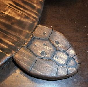

The body will need some detail work on the head and flippers. The head I did looks a little "snake-y", but its okay. You can do better. I know you can.
The flippers needed some, I guess you would call it "armor plates" on the leading edges.

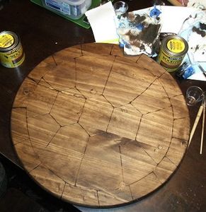

For the shell, I referred to pics and drawings I found online. I drew the outer circle first, and lines for each of the plates. The center row of the back plates was a series of hexagons. Then I drew lines joining the two.
Oh, and don't forget to add a few meteorite "pock marks" on the turtle and shell. I just randomly drew on some circles of varying size. Maybe ten or twelve. None more than 3/4 inch or so. Then I erased the plate lines inside the circles.

You may notice, in the pics, that I "burned" the turtle body a bit. I actually used my crème brulee torch for that. The reason being, originally there was going to be a much larger lazy Susan between the body and the shell, and the whole thing would spin, elephants and all. I decided that would look odd, so I rummaged around till I found a smaller one that I could use on the disc.

It's now time to do the shell and the turtle body. Both will use the same technique of applying India ink to the stained surface.
Pull out the India ink and the small brushes. You could probably use just one brush if you rinse fairly well between colors.
We're going to go in this order: brown, sepia, black.
Using a small brush and light strikes, start at the burned-in line and feather a brushstroke towards the center of each shell plate, getting smaller with each color layer.
Do all of one color at a time. That way, if you need to touch it up a bit before moving on, you won't need to redo another color, as well.

I also put several felt tabs on the underside of the turtle body. One over each screw hole and one under the head and each flipper. Add more if it seems wobbly.
