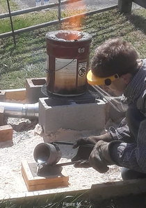

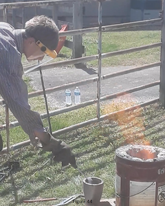

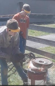

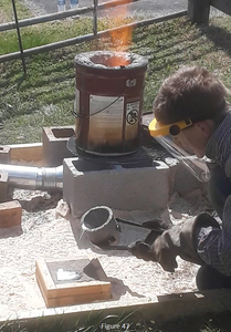

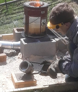

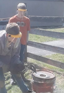

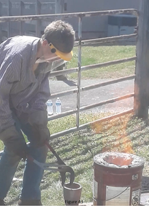

Put all the items you need in a safe area for the pouring. You will melt the metal and then put it straight into the mold. Do this in a sandpit, because the metal can react with water trapped in concrete and damage the concrete. Now you have to melt the metal before pouring (see figures 41 and 42). Aluminum melts at 1220 degrees Fahrenheit, that's 660.32 degrees Celsius. Make sure you have enough molten metal to entirely fill the mold and some extra. Have somewhere to dump the leftover metal, if left in the crucible, it can ruin it!
Step 12: Pouring the Metal
After the metal is entirely melted, skim the dross and poor the metal (see figures 43 through 46). Pour consistently without stopping. Stoping can damage the part. When the metal starts coming out the sprue and/or riser, it is full (see figure 47). Don't forget to put the leftover metal somewhere.
