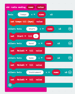

Step 7: Instrument - Reciving Instructions
This is the code for reciving commands.
We expect to get a word and a value.
Tempo will .change the tempo to the recived value and it should change the tempo for the entire band.
Start will make the micro:bit start playing its melody.
Now the next three changes the melody that the micro:bit play and you have 3 options
Band changes the melody for the entire band.
Instrument changes the melody for a group of instruments, so you can group several micro:bit together. Change "Instrument" to the name of the group the micro:bit is in.
Name changes the melody for individual instruments. Just remember to change "Name" to the name you want the micro:bit to have.

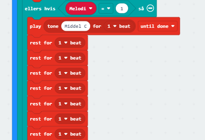

Step 8: Instrument - Melody
This is the part of the program that runs the melody or beat.
As you can see it will forst start runing a beat when “start”=1. That is also how we syncronize the micro:bits. When we first turn on the instruments “start”=0 and so they will all just sit and repeatly so nothing. Then when they get the start signal they will all start playing the melody at the same time and with the same beat, so they will stay syncronized.
You can change the sound or when they play on the beat. You can also add a halfbeat at start and the end, to get the instrument to play on the off beat (Remember to remove a whole beat).
