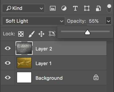

  1. Use a texture stock image (labeled for reuse). Drag and drop the image into the canvas. This will place it as a layer on top of the base image.
  2. Use the transform tool to enlarge the document to cove the whole area.
  3. Click the drop-down menu for the "blending styles" above the layer pallete.
  4. Apply the "soft light" blending mode.
    • You may want to adjust the opacity of the texture layer to soften the impact on the base image.
