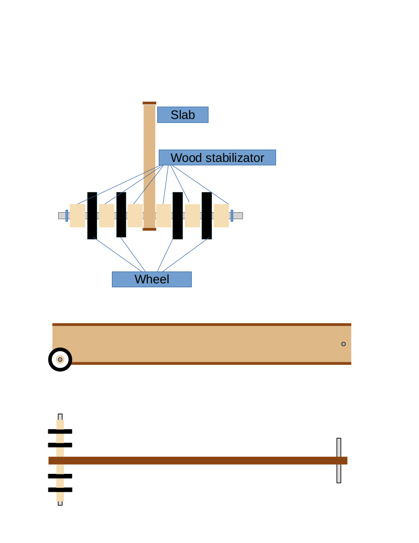

Instead of thinking of a buggy on which we will attach the slab, we decided to transform each slab in a self moving one.
We had a set of 4 steel lawn mover wheel and 1 steel rod (for another project).
We add some piece of wood between each wheel to stabilize them, pass the rod in 2 wheels and 2 separators, then go through the slab and after that added the 2 remaining wheels and separators. We secured everything with the hose clamps.
And that's it.
We then were able to move all our 13 14 feet hemlock slabs

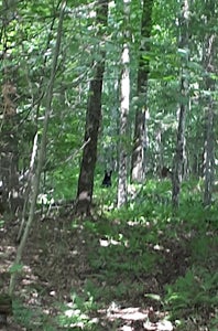

When we had finished to move all the slabs, we came back to clean up the place...
we heard some wood cracking... And see in the middle of the picture who was watching us ;)
