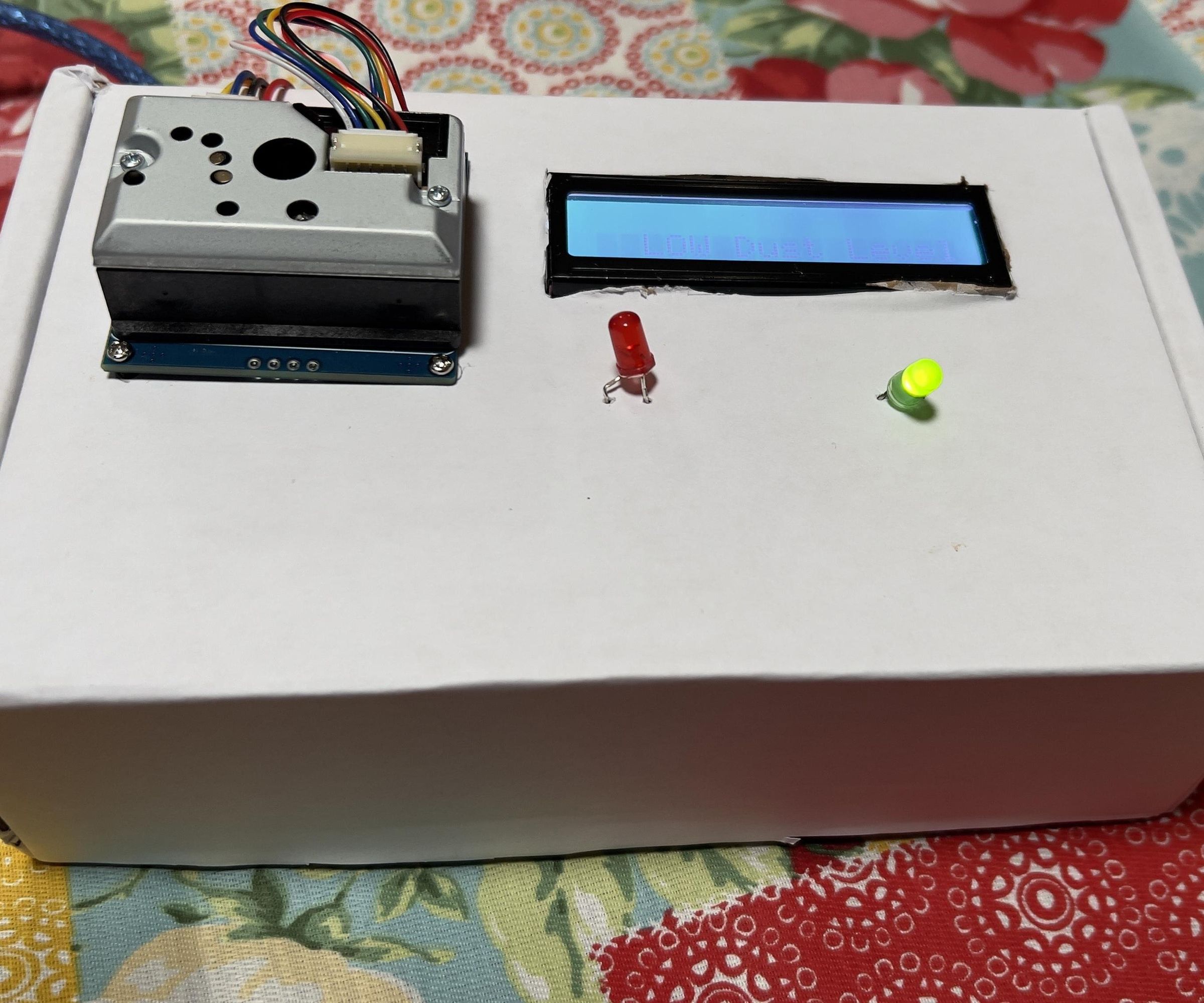

Let's face it-we all lose our things. From our phone to our car keys, to even an important letter, it all mysteriously goes away. I'm a student, and I misplace my school supplies very often. To solve this issue, I worked for a few days on a box that will securely store my items, and will also track capacity, so I don't overfill the box. This is a relatively simple project-it uses only a few components.

Step 2: The Circuit
This circuit has an ultrasonic, a servo, an LED bar graph, a slide switch, and an LED indicator. Turning on the switch will allow the servo to rotate, and the indicator will turn from green to red. One thing to note: in the diagram, the light blue wire is meant to be a 104-ceramic capacitor.

Step 8: The Code
The following is the MicroPython code. Specify the height of the box in lines 54, 60, and 61(wherever it says '29.6', that was the height of my box)
