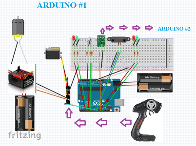

Assemble the Electronics as shown in the Fritzing Diagrams attached after ensuring you have all the necessary components mentioned in the INTRO of this project.
To ensure it is done correctly I will list the Arduinos and there connections here:
Arduino 1:
Pin 3: Led 1 w/ 220 Ohm Resistor
Pin 4: Led 2 w/ 220 Ohm Resistor
Pin 5: RGB LED Red w/ 220 Ohm Resistor
Pin 6: RGB LED Green w/ 220 Ohm Resistor
Pin 7: RGB LED Blue w/ 220 Ohm Resistor
Pin 8: Echo Pin of the HCSR04 Proximity Sensor
Pin 9: Trigger Pin of the HCSR04 Proximity Sensor
Pin 10: Channel 3 PWM signal pin
Pin 11: Led 3 w/ 220 Ohm Resistor
Pin 12: 315Mhz Transmitter
Pin 13: Led 4 w/ 220 Ohm Resistor
Arduino 2:
Pin DS: Connect to the Recieving Pin of the LCD Display
Pin DR: Connect to the Sending Pin of the LCD Display
Pin 11: Connect to the 315 Mhz Reciever
The trickiest portion of the assembly will be regarding the Tactic reciever. The 2nd Channel will easily allow the servo to be attached, the same is true for the ESC in the 1st Channel. Here is where it gets a little tricky. In order for the 3rd Channel to give a signal to our arduino, the code requires a reference voltage, and therefore we need to use the same ground as we use in our arduino set-up. In the fritzing diagram you will see that the GND plug for the Battery row on the Reciever is attached to the arduino GND. You can then attach the signal pin from the 3rd channel to pin 10. This will allow the button on our Tactic remote to communicate with our arduino, and interact with the lights. (See Coding Step.)
*In the final photo, you can see how I arranged the electronics in my project. I recommend adding a balloon to your servo push rod to keep out any water from getting into the electronics box.*
