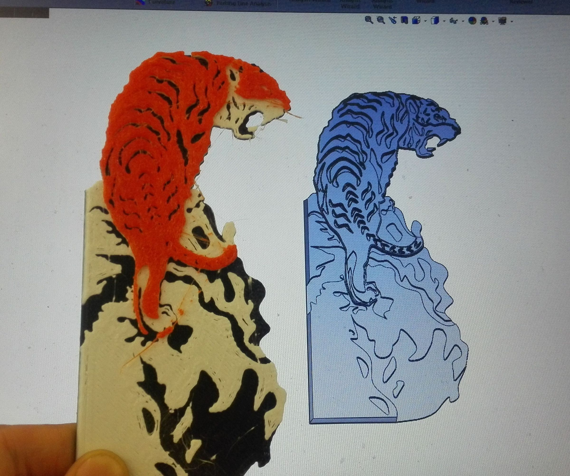

This instructable will combine art and 3d Printing together to recreate the painting "The Great Wave" by Katsushika Hokusai. The wave is made up of 4 filament and colors: Brown, light blue, dark blue and white. The way this works is that you print an stl of the wave, after certain amount of layers with one color you change the color into the next to get th multiple color look from above. This concept may be hard to understand so please read through the rest of the instructable which will explain the concept and the intricate steps involved.

Combining art with 3d printing requires some math to get the image just write when printing.This step will make sense once the later steps are viewed. You have to calculate how much of each colored filament is in each section before you print so you have them lined up so once a color is done, the next is immediately witched in. Since there are 3 layers there will be 3 different lengths of filament to switch in. The diagram shows this principle of how the extrusion layer work from a side and top view.
Attached is a cad of the model we are printing (it is very flat like a painting with layers of filament instead of paint). I cadded it using an image and extruding 3 layers representing the 3 colors that will show.

The first layer is brown to makes up the boat in the foreground. To figure out just how much filament length of blue for the first layer you have to do some math. Using the rollback feature of SolidWorks, you can see just the first layer is shown and you can measure the volume of the layer. Since extruding is just depositing the filament to fill the volume you just have to find what length of filament of certain diameter (1.75mm or 3.00mm) will equate the volume of the first layer. Below is a shorten explanation of the math:
Volume of layer= length * area of filament
(Get volume from cad and area of filament from manufacturer information)
.1600 in^3 = length * (pi (1.75mm/2)^2)
(Remember to convert the unit if needed)
length =42.92 in ~ 45 in
(added extra 2 from experimentation and its better to have extra filament than less)
Step 4: Print Second Layer
Now you get the math for the first layer, the second layer will be easier to understand! The second layer is the yellow that shows the turquoise part of the wave!
To get the volume of the second layer only, you have to rollback to just the first and second layers to get the volume of first and second. Then you subtract the volume of first from the previous. Next use the math again to calculate how much filament needed.
The math gets 39.27 but we will use 41 inches from experimentation. You will definitely want to experiment before having it work on your printer. Watching the first layer and seeing when that becomes the second layer as you change it will get you a better idea of how close the estimate length are.
Step 5: Print Third Layer
The third layer is the dark blue part of the wave that contrast the light blue sections. This third layer is the second to last layer and you just got to do what you did for the second layer. By subtracting the volume of first and second from the volume of the rollback (first, second, and third), you isolate again this layer. Now you repeat the same math. You get 32.37 inc, rounding that to 33 inch is good (you will still have to do some experimentation!
Step 6: Print Fourth Layer (last)
The last layer is a white color to add the white foam from the wave that gives it the majestic feeling. The last layer is the easiest, you don't even need to calculate length! Since the print will finish, you can just put more than enough of the last color because you dont need to switch again.
However this makes the third layer (and first layer a bit) very important in length control. If you have too much dark blue, there might not even be enough time to put in white. It is important to experiment with the filament lengths! But most importantly it is to have fun while pushing the boundaries of 3d printing to create art!
