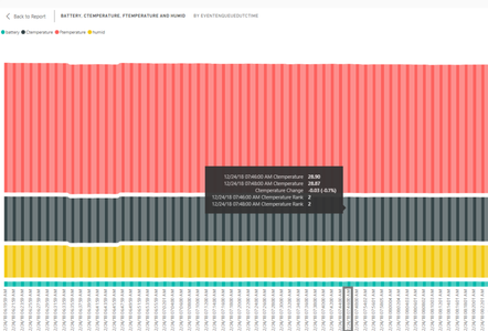

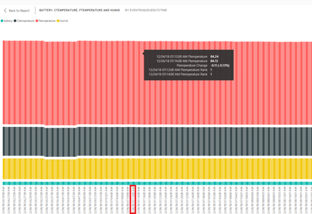

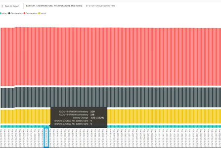

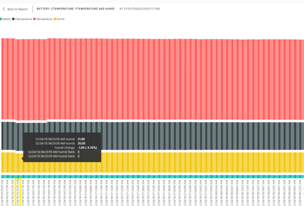

Step 5: Data Visualization in Power BI
Here we are visualizing our sensor data at different dates and time. We can see the percentage change in Humidity, Temperature and Battery Usage during different days with there values respectively.

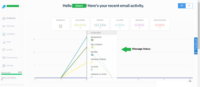

Step 6: Azure Email Hosting for Wireless Temperature Sensor Using SendGrid
Software as a service(Saas application) provides another amazing feature called SendGrid. In Microsoft Azure, SendGrid support swiftly delivers Email notifications to different Users.
The setup for Send Grid is described in this blog.

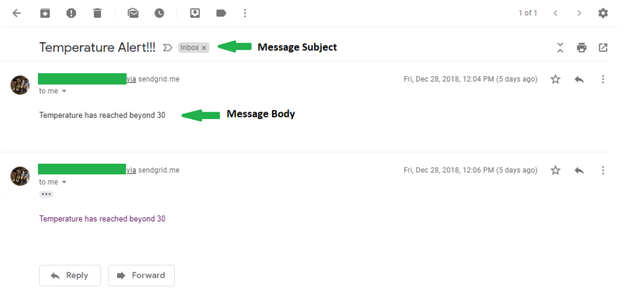

  • Whenever the temperature crosses the 30 degrees threshold. The user will get a mail to the described email id.
if(product.Ctemperature > 30.00){
smtpClient.Send(mail); }

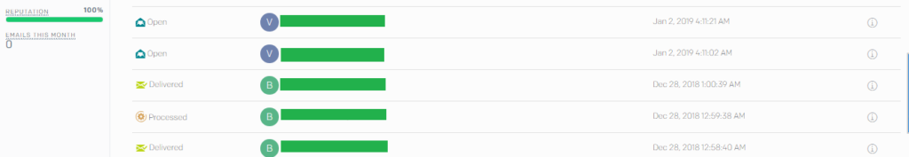

Notification Outcomes
  • An automated email notification will be delivered to the user eachtime the temperature crosses 30 degrees mark.
  • Send Grid delivers the Email Notification to the same subject everytime. We don't have to scroll down in the inbox in search of last delivered message. Just search for the Temperature Alert!!! and you will get the list of messages.
