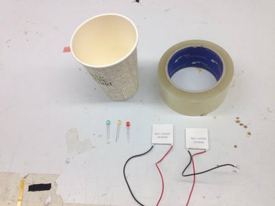

- 2 Thermo Electric Generators (peltier elements) (TES1-127025) (15.4 V/DC 2.5 A 21.4 W (l x b x h) 30 x 30 x 4 mm) +/- €10
- Transparent tape
- 2 paper tea cups
- 1 Red LED (20mA, 5V)
- 1 Stanley knife
