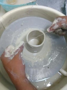

Step 8: Cutting the Wall, Getting It Off
getting it off; Put water on one side. Get the wire and wrap with your thumb and side it on the bottom, like two times. After you do it back and forth you will be able to side it off. Slide it into a piece of wood and let it try for couple of hours or a day and make sure its not too dry so you can trim.
