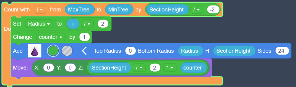

This Christmas tree is made of cones. The bottom code is wider than the one above it. All the sections of the tree the same height. The values are stored in variables you can modify them and play around.
To start with Drag out "Create Variable" then rename the variable. You need to take out and rename each variable one at a time.
You can change the values of the variables.
  • MaxTree is the Tree Height.
  • MinTree is the height of the last Section
  • Section height is the height of a section.
  • Radius and counter are used in the program later.
In order to build the sections we will do a loop. Since we want the width or Diameter of the tree to be bigger at the bottom and smaller at the top we will create a loop that counts backwards. We will start at MaxTree and count down by 10 until we get to MinTree.
In the loop we set the Radius of a cone as half the diameter. We use the radius for other calculations like adding bulbs.
The counter is incremented each level and is used to tell the cone how high it needs to move to be at the right height.
