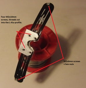

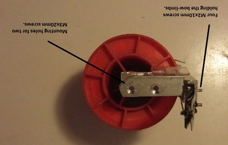

Step 1: The Templates for the Wooden Parts, Plus Some Close Ups
Best way to start, 2 pieces of wood, around 4mm thick. Make sure the COVER template fits it.
Then screw them together, and cut out the cover.
After that, one rear, one front inlay, and boom, there are the main parts for the bow.
For the back-plate of the bow limbs, you can use any metal,
I had 2mm aluminum laying around. Copy the holes, cut out a bigger gap for the arrow, and done.
The rest is explained in my video. Have fun
