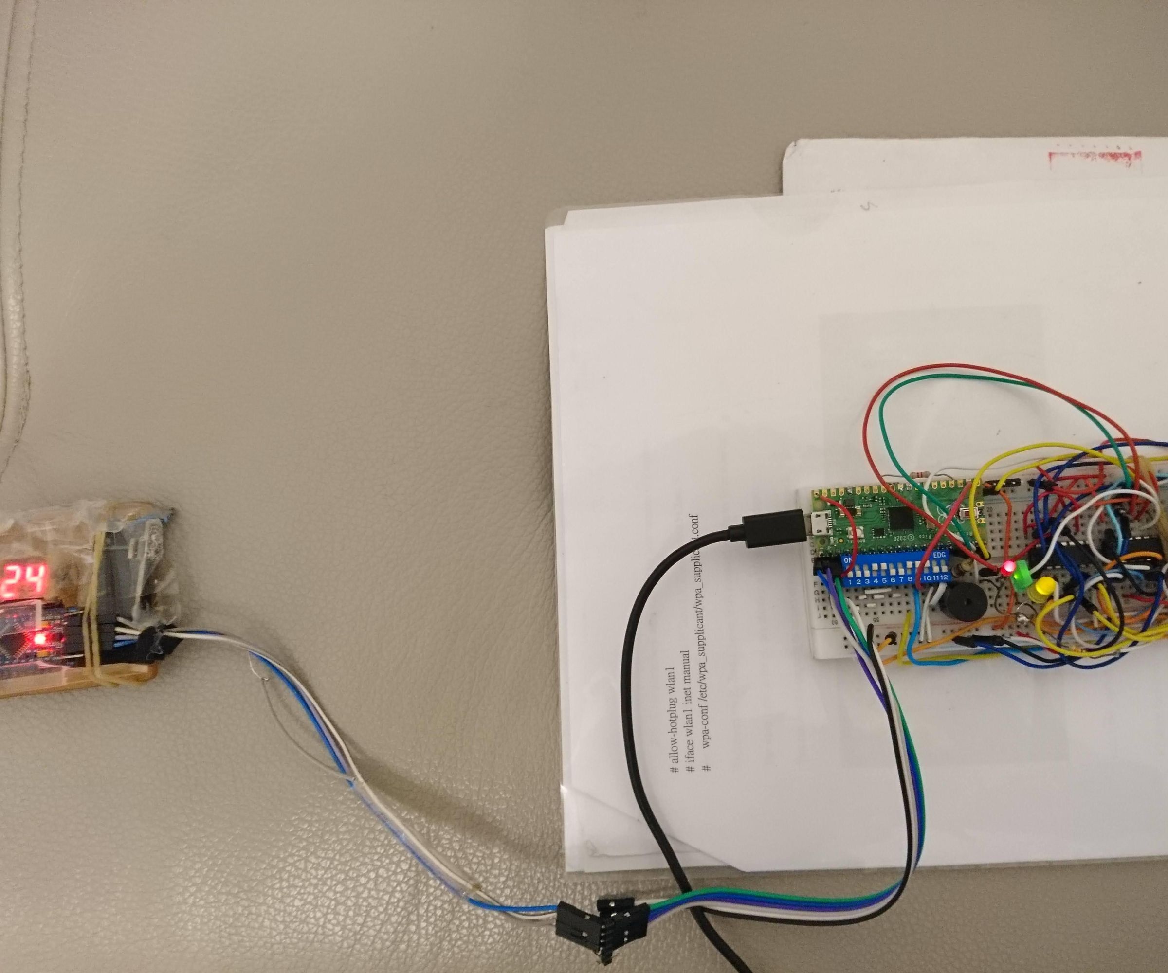

i am figuring about the part 4 roller bot out that arduino running in multi-program
crashing out ! (Tiny Robot Plat Form With nano_part_4 + reset circuit)
IN CODING(nano_part_4):
so i have to write a sub-program in order to reset it's self every second.
or it will not both receiving next remoter signals and running at the same time!
and finally, i use pi zero instead then.
because it's supporting multi-tasking!
and then , i slim it by took apart the IR receiver circuit and
took apart nano and the reset circuit, and remote it with
a wireless keyboard in order to speedup the response time.

Step 4: Wiring Up
Connect pi_zero to the PCB,
and then connect battery and motor together.
*** you need to save the code last step to EX: remote.py
and you append the .bashrc
"sudo python remote.py" in the last line
in order to boot up and run ! ***
