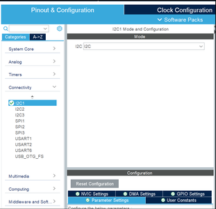

Step 4: I2C Configuration
Configure the I2C mode to I2C under Connections Menu

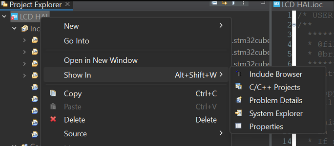

Step 8: Opening the .elf File Created in System Explorer
Right click on the project and click on show in system explorer and copy its path

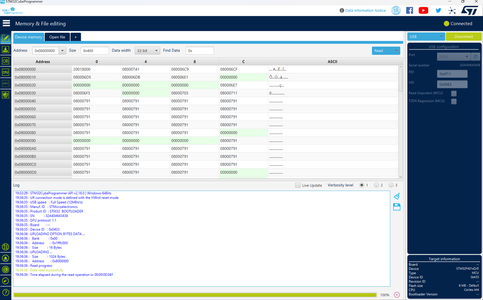

Step 9: Open STMCubeProgrammer and Connect to STM Board Via USB

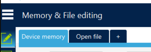

Step 10: Click on Open File and Paste the Copied Path
Step 11: Go to Download Options (Found in Toolbar on the Left)
Step 12: Change Download Options and Click on "Start Automatic Mode"
