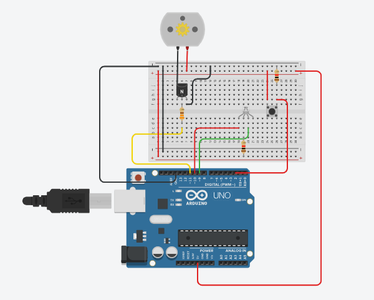

Introduction: Toggeable Fan
This will teach you how to build a Toggleable Fan using an Arduino UNO
Motor, Breadboard, Arduino UNO, NPN Transistor, Resistors (1k,330), Propeller
Step 1: Get Arduino and Breadboard
This is where you will be building the machine
Step 2: Add Motor
Step 3: Add Pushbutton
Step 4: Add RGB Led
Step 5: Code

Step 6: Build in Real Life
