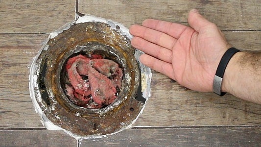

The only way to know if you need this repair is to remove your toilet.
After the toilet's removed, inspect the closet flange.
Toilet flange repair is one of those things...you don't know you need it until you see a leak or see the flange when replacing a toilet.

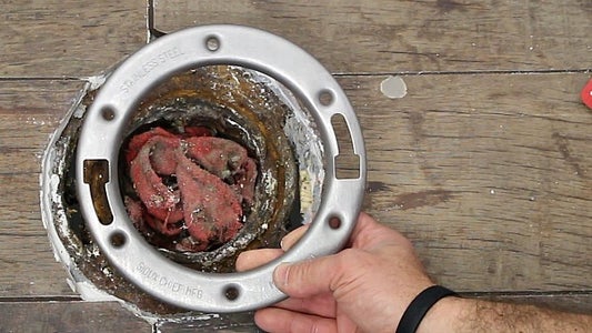

Today I'm going to share three options for repairing a toilet flange. Your first option is to buy a replacement closet flange ring.
This has to be secured to the subfloor with screws.

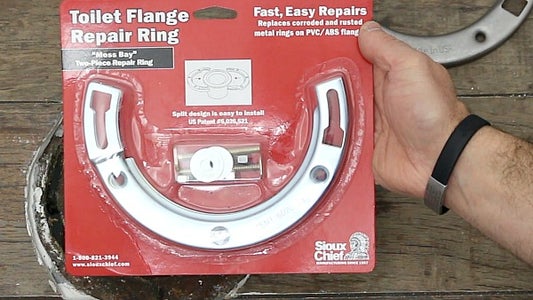

A second option is to use a closet flange repair kit.
It's a great option if your existing closet flange is broken or rusted. Due to it's construction you can only use a toilet flange repair ring on PVC or ABS pipes.

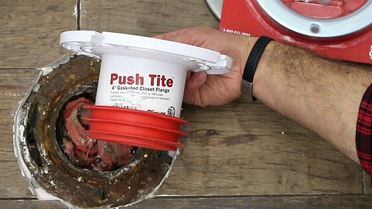

Option 3 is the easiest. It's an a Push Tite gasketed closet flange.
Simply push this down into the old closet flange and secure it to the wood subfloor with galvanized or stainless steel screws.

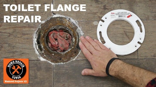

Charlie taught me this second tip, a closet flange should be flush or up to 1/4" above your finished floor. The reason why is because wax rings compress over time. If the closet flange is below the finished floor, a gap will form between the bottom of the toilet bowl and top of the wax ring. This gap is where water leaks when you flush your toilet...and we all know what's in toilet water. YUCK!!! How do you raise the closet flange?

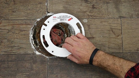

Step 4: Use a Closet Flange Extender
Closet flange extender rings are man/woman's best friend when repairing closet flanges.
These come in 1/4" and 1/2" increments.

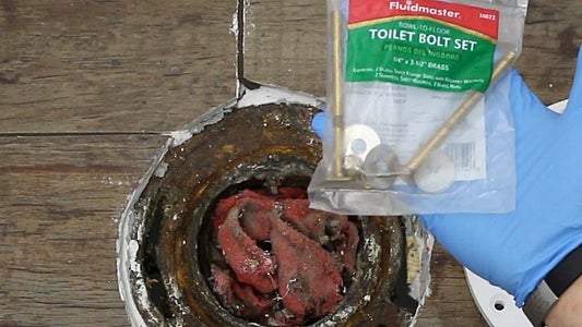

You can find them at the local home store or hardware store. Also, you'll need extra long closet flange bolts, e.g. 3 1/2" bolts. These bolts will slide into the old flange.
I tried to explain Charlie's repair to the guy at my local plumbing supply warehouse and he was totally not following the concept.
So hopefully I do a better job explaining it to you. Basically what we're doing is sandwiching the new closet flange extender ring (or spacer, whichever) onto the old closet flange. But you need the closet flange bolts to be long enough to fit up through the base of the toilet bowl. Furthermore, clean off all the old wax from the closet flange using a putty knife before installing the closet flange extender.
I used a 1/2" closet flange extender in this project because it extends about 1/8" above the finished tile floor.

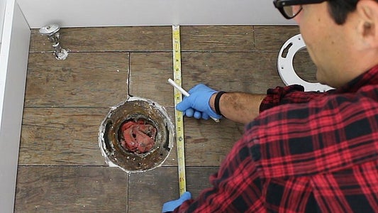

Also, I'll be installing a new American Standard VorMax toilet in this bathroom. The rough in size for the VorMax is 12 inches, i.e. the distance from the closet flange bolts to the wall is 12 inches.
Know your rough in before installing the closet flange bolts because the last thing you want is to place your bolts 13 inches from the wall when you need them to be at 12 inches.

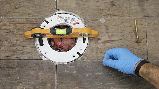

Don't measure from the baseboard to the the closet flange bolts as this will give you the incorrect rough in. If you do measure from the baseboards to the bolts just deduct the baseboard width from your dimension. Dry fit the closet flange extender onto the old closet flange and place a torpedo level on it.
If you're in luck the closet flange extender will be level, but if it's not...you'll have to shim your toilet when you install it.

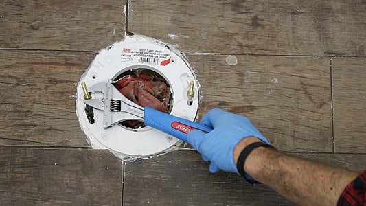

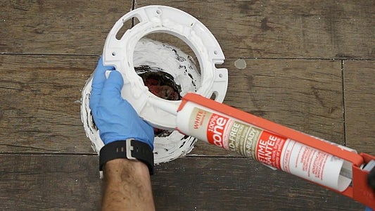

Not a big deal, just a good thing to know. Apply a generous bead of 100% silicone caulk on top of the old closet flange.
And to the bottom of the new closet flange extender.
Either slide the new closet flange bolts into the old flange before adding the extender or add them after you adhere the extender to the old flange.
Consequently, I chose to add one of the bolts to the old flange first since it was a tight fit.
Add metal washers and nuts to the closet flange bolts. Finally, tighten the nuts to the bolts with a crescent wrench until the bolts are nice and snug.
