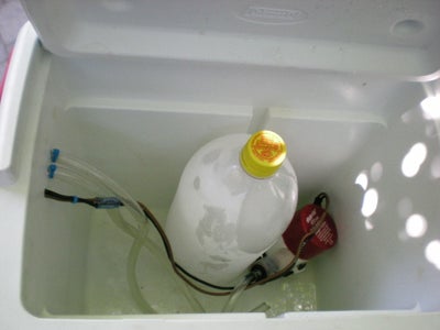

Ice Chest - any size, larger can hold more ice for longer cooling.
Plastic beverage bottles: At least two of any size. One to freeze and the other to use in the backcooler. I use two 1 liter pop bottles. Fill with fresh, clean water 2 inches from the top to allow for expansion. Remove the labels! The pump doesn't like label fragments!

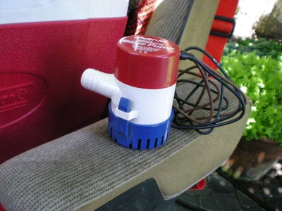

One 12v submersible bilge pump, 350 gallons per minute for single seat, 500 gpm for a double.
One cigarette lighter plug with 2A internal fuse

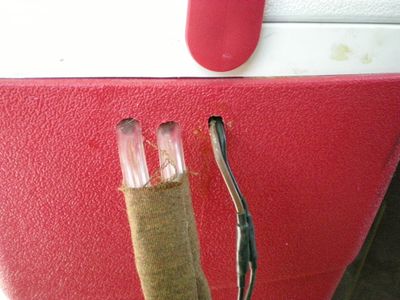

Drill two holes for the 3/8" tubes and one for the wires. Size your drill bit so they are snug. The position must be near the top of the chest. The lines will tangle less if it's near the pivot of the handle, it depends on how your ice chest is made. Think twice, drill once
Bilge pump: It will work in any position so I didn't mount it. Most pumps have a mounting bracket, you can try gluing it to the bottom or side of the chest. It's easier to clean the pump and chest if it's not mounted. My pump has a 3/4" OD outlet, find the tube size and adapter to fit yours. The seal does not have to be water tight on the bilge pump.
Connect the wires to the bilge pump wires outside the ice chest. The Rule model pumps are not polarized, but if yours is connect it correctly! If you want to put a switch in line, go for it. You can also wire it to your car's fuse box with a disconnect.
The supply and return tubes are interchangeable. Make the lines long enough to reposition around ice bottles if needed.
Use the nylon ties on the inside to keep the tubes and wires from being pulled out. Not too tight!

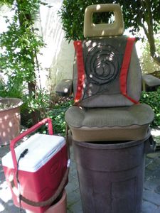

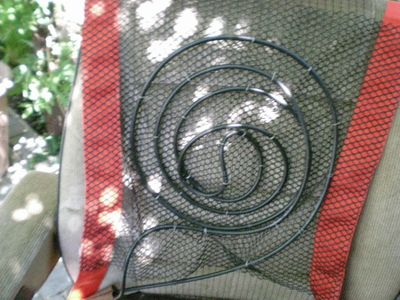

The idea is to put about seven feet of tubing on the back of a seat so it contacts your upper back and can absorb heat which cools you off.
Use nylon mesh like that pictured or get a car seat cushion and fasten the tubing to it. I used UV resistant, heavy thread with an upholstery needle. My technique needs some improvement and if anyone has any suggestions on how to attach the tubing to the mesh securely and quickly, let me know. I did try threading the tubing in and out of the mesh, but it distorts the mesh and takes a long time.
The tubing must not be kinked, so any pattern that you like should work. I sized it so my back would cover the tubing and reduce condensation. Place it on your wide upper back, do not use it near your kidneys in the small of your back.
Supply and return lines are interchangeable.
I had a friend sew some UV resistant upholstery fabric into a tube, about 1" diameter to hold the vinyl tubes together, insulate them and reduce condensation. Don't sew? Use pipe insulation, taped on plastic packing material or leave them bare.
The length of the supply lines depend on where you use this. Shorter is better.
