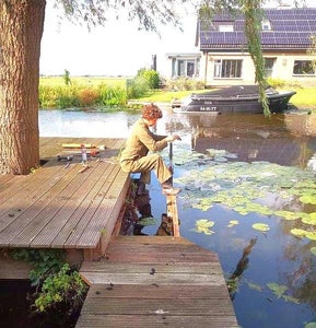

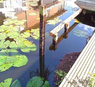

Our backyard is surrounded by water and the previous owners of our house built a deck partly above the water. This deck is supported by posts that are standing in the water. One part of the deck was quite bad and partly rotten, so I decided to remove it. It was easy to remove the deck itself, but then I had to find a solution to remove the posts.
I did not want to cut them just beneath the water line, because children sometimes play on the water with small inflatable boats and the posts could damage their boats.
Our neighbors also removed part of their deck, but they hired a contractor with a large steel boat and a hydraulic machine to pull the posts out. I decided to try to build a tool that would help me remove the posts by myself. It worked surprisingly well, so I decided to share what I did.

Remove any horizontal beams connected to the posts, so you have just the wooden post itself remaining in the water.

Here you see me using the tool. I added a string to the spanner so I would not have to dive for it in case I dropped it into the water.
Since the spanner can only turn the nut about 120 degrees, it takes several minutes to pull the post up about 30 cm (one foot).
