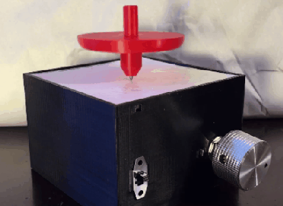

Theory of Operation:
The Top that Spins Forever consists of two parts, a spinning top and a base. The top contains a magnet hidden under the surface of the plastic, and the base contains a motor holding a magnet. The top continues to spin because the magnet inside the top wants to align with the spinning magnet inside the base.
Why do the magnets "want" to align? A full explanation of how magnets work would be beyond the scope of this Instructable, but an excellent resource is How Stuff Works. If you imagine the magnetic field of each magnet leaving the north pole and curling around through the air to the south pole, anything in this field that makes it easier for the field to travel from North to South feels "attracted." If the magnets face opposite directions, they assist each other's fields and are in a stable position. If they face the same direction, the north pole of one pushes the field from the north pole of the other away. In this situation, if one magnet is free to spin, it will. The magnets will naturally align north to south. See image of magnets.
Because the magnets align, if they start aligned in opposite but parallel directions and you turn one slightly clockwise, the other will be pushed to turn clockwise as well. As naturally follows, if you have a top which a user spins, as long as you have a magnet underneath spinning in the same direction at the same speed, the top will keep its speed.

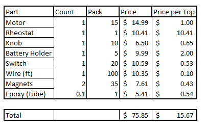

    Pricing:
    See the image for pricing information, but excluding the printing supplies this project will cost you $16 per top. If you do not have anything on hand and choose my recommendations on what to purchase (in bulk), it will cost a hefty $76.

    Step 4: How to Use & Other Fun Stuff
    So you made the next coolest toy... Now what? If you ask me, it is pretty useless if you do not know how to use it!
    How to Use:
    1. Spin the top clockwise between your thumb and pointer finger. Lefties have to spin it backwards, which can feel awkward. If the motor is hooked up in reverse polarity it switches this around and makes it easier for lefties.
    2. Once you get a good spin, you may need to tilt the base to get the top to slide to the center, right over the magnet.
    3. Flip the switch and turn the knob clockwise until you hear the motor turn on.
    4. Turn the knob counter-clockwise to slow the motor down until it has almost stopped. You should hear it change tone when it syncs up with the top spinning above it. This may take a few tries.
    5. Slowly increase the speed by turning clockwise until the top is spinning stably at decently fast pace, likely a little faster than you would spin it by hand.
    You have done it! Congratulations. Show all of your friends and your cool neighbor who likes to build stuff.
    You can increase the speed beyond this, but the top will eventually become out of sync with the motor and you will hear the motor jump way up in speed. I enjoy getting it going super fast and then dumping it off the platform onto a surface I do not mind scratching and watching it spin.
