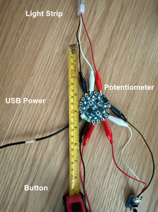

Assembly Instructions
  1. NeoPixel strip: connect DIN (signal) to A1, 5V to VOUT, and GND to GND.
  2. Potentiometer:
  3. Middle pin → A6
  4. One outer pin → GND
  5. Other outer pin → 3.3V
  6. Button:
  7. One side to A4
  8. One side to GND
  9. Use pull-up configuration in code
  10. Mount components on a stand or enclosure as needed. Ensure light visibility and ergonomic access to the button and knob.

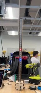

Step 1: Game Rules and How It Works
This game is similar to a popular "Circle of Lights" game that could found at arcades like Chuck E Cheeses (displayed in picture above).
One moving light scrolls smoothly up and down a vertical light strip ("Tower").
One target light stays fixed in a random position.
The player’s goal: press the button exactly when the moving light overlaps the target.
A potentiometer allows you to adjust how fast the light moves (between 1 light/sec and 1 light every 10 seconds).
Each successful match triggers a rotating visual celebration, such as rainbow waves or soft color wipes.
Win streaks cycle through different animations, keeping the gameplay fresh and satisfying.
Step 2: Building the Case
To complete the Tower of Lights as a finished, playable device, I designed and built a two-part wooden enclosure using laser-cut plywood. The bottom box houses the Circuit Playground Bluefruit, potentiometer, button plug-in, USB connection, and all necessary wiring. It should be at least 3.5 inches on each side to provide enough internal space for routing wires and suspending components. This box includes custom-cut holes: one each for the USB cable, potentiometer knob, and button jack, as well as a slot at the top for the light strip to pass into the upper box. The top box serves as a display tower for the LED strip and must be as long as your NeoPixel strip (ours was 1 meter). One face of this tower is made of acrylic or another transparent material to allow the colorful lights to shine through during gameplay. Inside the lower housing, I added scaffolding supports made from wood scraps or brackets to hold the Bluefruit and potentiometer in place securely and keep wires cleanly routed.
