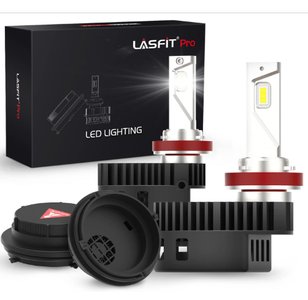

I upgraded from the old halogen low beams to some new LED bulbs in my 2019 Toyota 4Runner headlights. I bought the LASFIT H11 LED bulbs from Amazon for $170.
  1. LASFIT (or any bulbs of your choice)
  2. Electric drill with Phillips head bit
  3. 10mm socket and wrench
  4. Flathead screwdriver.

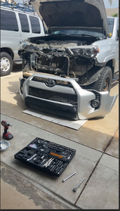

  1. First, begin by popping your hood and locating the plastic radiator cover.
  2. Remove all plastic pins (refer to the 3rd picture for the first set of pins, 4th picture is the pins located under the plastic cover) which is where the flat-head screwdriver will be helpful.
  3. Be sure to keep track of all screws and pins that are removed during the process.
  4. Next located in the wheel wells on both the driver and passenger side you will find 3 bolts you will need to remove. (drill or socket can be used)
  5. Finally, located under the vehicle there are another 4 bolts on each side that connect the fender liner to the bumper that must be removed (refer to the last picture).

  2. Carefully pull the unit out then locate the round grey cap and twist it off (refer to the 1st picture).
  3. Disconnect the plug going into the bulb and twist the bulb to remove it (refer to the 2nd and 3rd picture).

  1. Now reverse the process of removing the bulb.
  2. Fit the new bulb in and twist until snug.
  3. Connect the power source to the new braided power. These specific bulbs include a new cap for the bulb as well.
  4. Feed the cables into the housing unit.
