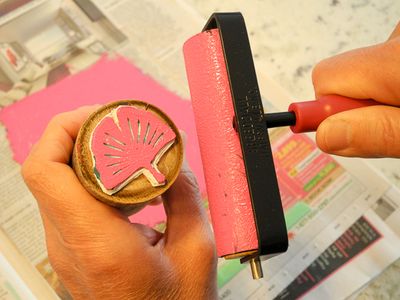

Step 5: Make Prints Using Your Lino Block Holder
You will need ink, and paper or fabric to print on.
There are several approaches to getting ink on your lino block:
  • Use a roller and spread the dye on a piece of glass or other smooth cleanable surface, roll the ink to an even consistency and then roll the ink onto the stamp.
  • Use a paint brush or a foam brush to apply the ink/paint/dye to your stamp
  • Use a pre-inked stamping pad
I found that applying the paint with a foam brush was the easiest and didn't waste as much paint as using the roller.
Once the ink is on your stamp, press the stamp firmly on your paper or fabric, then gently lift it to reveal the print.

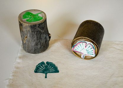

Step 6: Experiment With Printing Using Your Lino Block Holder!
The natural branch feels great in your hand and enables you to press down firmly and evenly to make your print.
Block printing is easy but the results will vary - printmakers enjoy the variations which make each print unique. I have experimented with different dyes, different printing mediums (fabric vs. paper) and different ways of applying the dye. A key factor is getting the right amount of dye and spreading it evenly on your lino block.
These 3 prints illustrate some of the variations. The first one is printed on fabric using a fabric dye, and the 2nd and 3rd examples are printed on paper - the 3rd one with a light green acrylic paint. Fabric will absorb more dye, and is more challenging - paper is a more forgiving medium.
