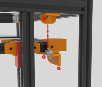

Step 6: Z Endstop
Materials:
  • Printed Parts.
  • Limit Switch.
  • M3x10mm x 4.
  • M3x30mm or more x 1.
  • M3x8mm + Nut x 1.
  • M2.5mm x 2.
  • M3 T-Nut x 4
  • Drag Chain ~250mm.
  1. This part on the top is for adjusting the (mechanical) minimum z by screwing/unscrewing a long M3 bolt which will in turn contact the limit switch on the bottom.
  2. This part on the bottom (fixed on the bed frame) has the limit switch fixed. Make sure that the long M3 used on the top part and the limit switch are aligned!.
  3. The bottom part is also used to fix one end of the drag chain that will lead the cables from the heated bed (as well as the limit switch) down to the main board. The other end of the drag chain is simply fixed on the vertical extrusion on the right (of the image) and at the very bottom.
