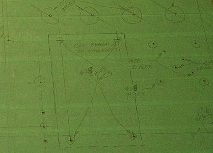

The four counter-sunk holes which show brightly in the next photo are for a small perf-board on standoffs that I knew I would need for some of the discrete circuitry.

Now all controls, binding posts, the power switch, etc are marked, in this case with press-on transfer Letraset lettering. Another painstaking task. Too bad I couldn't just feed the plate through a printer ... hmmm. Next, it's covered with 2 or 3 coats of spray-on Varathane and allowed to dry overnight between coats.
And then all parts are mechanically mounted.

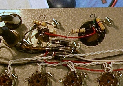

About the large filter caps: There are two pair of large filter capacitors, C1, C7 and C2, C8 which are stacked circuit-wise so that their combined voltage tolerance exceeds 700V. Thus, the top one of each pair must be fully isolated from the plate. Fortunately, I got two 125 uf/350V electrolytic cans from the Tek 545 which were covered in black paper. They can be seen in the 7th photo above. But the bottom of them was still exposed metal so I fashioned an insulator from some thin cardboard (Christmas card) and electrical tape and squeezed it between the cap can and the metalwork. That cap can is raised to about 275V DC above ground and the ad-hoc insulation does just fine (so far).

The 2nd shot here also shows the bridge rectifiers and filter cap cans for the HV sections wired up. The bridge rectifiers are actually four individual 1N5408 diodes. I might have used 1N4007's if I had any but these were the only ones I had that would stand the voltage. I used 1N4004's elsewhere. Again, I'm trying not to buy stuff but later on I find that I will have to break down for a few small bits (mostly 2 Watt resistors).
These big series-wired caps were biased with a 47K/2W resistor across each to make sure that the voltage across them was split more-or-less evenly. I also took a hint from Tek and fed each pair with a 10 Ohm/2W resistor (which I bought from a local hobby house). After I had them in and started to apply voltage I found them going off like popcorn. They were carbon film types! They don't conduct much current or drop much voltage (less than 2V) but if a microscopic crack develops inside them that crack suddenly has several 100's of volts across it and will arc over until the resistor is toast. This may take a minute to do but ends with fireworks! Replacing them with wire-wound types cured that one (Yeah, yeah, I should have known...). I show three of them (out of 4) which failed.

Step 14: Cable Lacing
As you can tell from the pictures above, I began lacing up the wiring instead of bundling them all with plastic ties. I have always admired the look of a well-laced harness. As with another project, I used some embroidery thread pulled over a lump of wax for the lacing cord since it seems that genuine lacing cord cannot be had anymore. I used the standard lacing knots for my harness. For those willing to learn this arcane art, Googling “harness lacing” brings up a couple of how-to sites.
This took about 3 hours to do.
