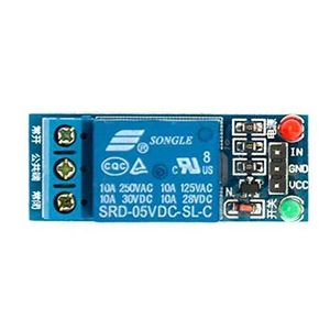

1 - 5 volt relay module

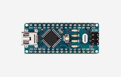

1 - Arduino Nano

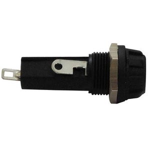

1 - Fuse holder
1 - Glass fuse(current rating of glass fuse should be the current rating of relay module)

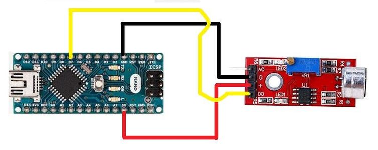

Step 3: Connection Between Arduino Nano and Sound Sensor
Connection
DO PIN TO D7 PIN OF ARDUINO
(+) TO 5VOLTS
(G)TO GND PIN OF ARDUINO

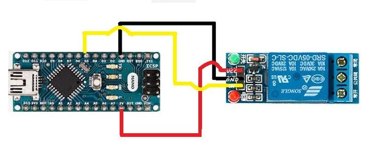

Step 4: Connection Between Arduino Nano and Relay Module
IN PIN TO DIGITAL PIN 5 OF THE ARDUINO
VCC TO 5 VOLTS
GND TO THE GROUND PIN OF THE ARDUINO

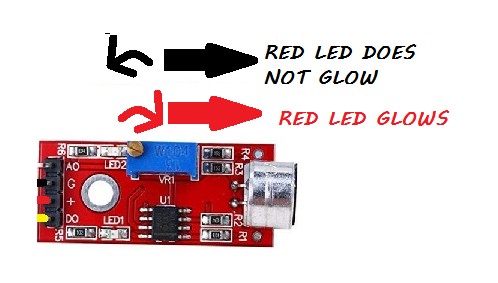

Step 6: Adjust the Sensitivity of the Sound Sensor
To adjust the sensitivity of the sound sensor. Turn the trimmer anticlockwise until the built in red led is not glowing. Slowly turn the trimmer clockwise until the built in red led is starts glowing. this is how to adjust the sound sensor.

Step 8: WIRING UP MAINS WIRES TO RELAY MODULE
CONNECT THE EARTH WIRE OF THE POWER CORD TO THE EARTH TERMINAL OF THE AC SOCKET.
CONNECT NEUTRAL WIRE TO THE NEUTRAL TERMINAL OF THE AC SOCKET.
CONNECT THE LIVE WIRE TO THE COMMON TERMINAL OF RELAY MODULE AND CONNECT A SHORT PIECE OF WIRE TO THE NORMALLY OPEN TERMINAL OF RELAY MODULE TO THE LIVE TERMINAL OF THE AC SOCKET.

Step 12: USE a FUSE
Use a fuse holder with a proper fuse to match the rating of the device. you can plug a device which can draw up to 10 amps which is in 220 volts is 2200 watts but I recommend you to use a device which draws less than or equal to 2000 watts because the relay contacts would wear out easily. The relay I use for this project is only 10 amps so I used a 10 amp mains cable and 10 amp fuse to blow up if I draw more than 10 amps.
