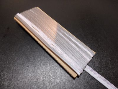

  4. Reflective piping (optional): you could salvage it from an old jacket. It should be long enough to cover the entire bottom of the cape.

  4. 反光片(可以略過): 你可以拆下舊夾克的反光片. 它的長度要足以蓋住斗篷的底端

Step 4: Installing the Reflective Tape 縫紉上反光片
The installed reflective tape should look like this.
反光片縫上後應如圖所見.

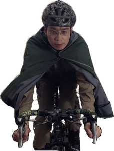

Step 6: The Completed Project 完成的成果
The completed project should look like what the pictures show.
完成的成果應如圖所現.
Step 7: How to Use the Bike Poncho 如何使用單車斗篷
There are three modes for wearing the bike poncho:
  1. Rain coat mode: the cyclist would pull the zipper on, put his/her hands through the hand loops, and cover his/her head with the hood. This mode also provides more warmth to the upper body, and should be good for temperature between 55-60 deg F or 13-16 deg C
  2. Arm warmer mode: the cyclist would put the his/her hands through the hand loops. This mode provides warmth to the arms, and should be good for temperature between 60-65 deg F or 16-18 C
  3. Attack on Titan mode: the cyclist would let the bottom of the cape hang free to provide maximum air flow. This mode provides maximum cooling, and should be good for temperature above 65 deg F or 18 deg C.
There are limitations with the bike poncho. It works best when the rain is coming down straight, and doesn't work well when the rain is coming down sideways or when there are lots of road spray from nearby traffic. It also provides lots of air drag, so it is really meant for bike commuting or touring.
單車斗篷有三種穿著模式:
  1. 雨衣模式: 單車騎士把拉鍊拉上, 雙手穿過把帶, 並把頭罩蓋上. 這個模式同時提供上半身的保暖, 可使用的氣溫約華氏55-60度或攝氏13-16度
  2. 手臂套模式: 單車騎士把雙手穿過把帶. 這個模式同時提供手臂的保暖, 可使用的氣溫約華氏60-65度或攝氏16-18度.
  3. “進擊的巨人"模式: 單車騎士讓斗篷下端自由擺動已提供空氣流動. 這個模式提供最多的散熱, 可使用的氣溫約華氏65度以上或攝氏18度以上.
單車斗篷有些缺點. 它可以成功地擋住垂直落下的雨滴, 但是卻不能擋住橫向的雨滴或臨近車輛的噴濺. 它同時產生相當大的風阻, 所以它僅適合單車通勤及旅遊使用.
