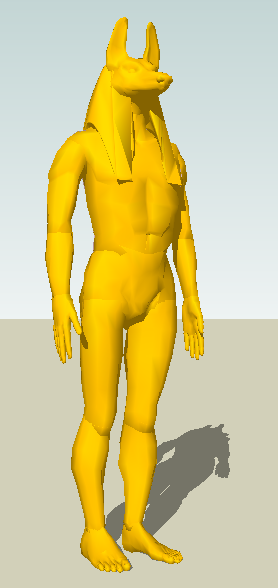

Step 1: Cut Your 3d Shape to Make It Fit in Your Hot Wire Cnc
The first thing I did was to cut the 3d object in smaller pieces for two reasons: 1. it had to fit in my foam cutter cnc (that is 60 cm high); 2. I only needed the left half of the body for the next process, because, you'll see in a minute that I easily mirrored it.

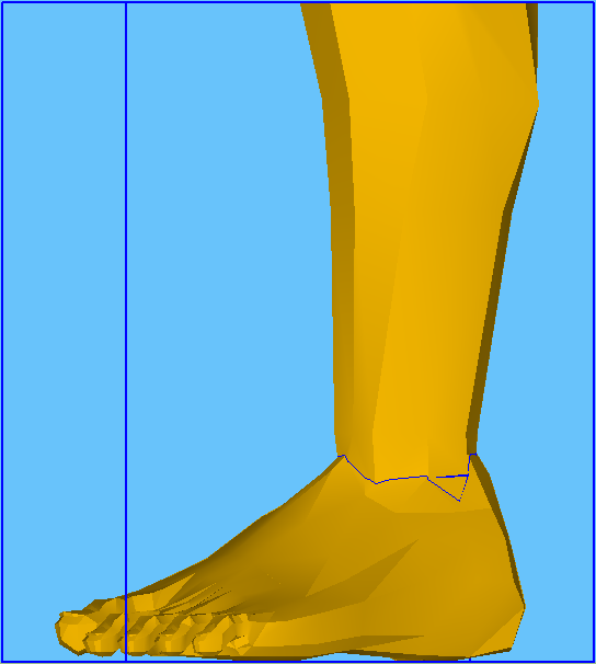

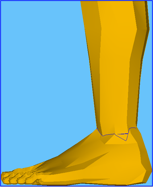

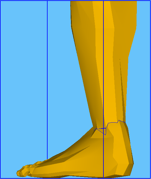

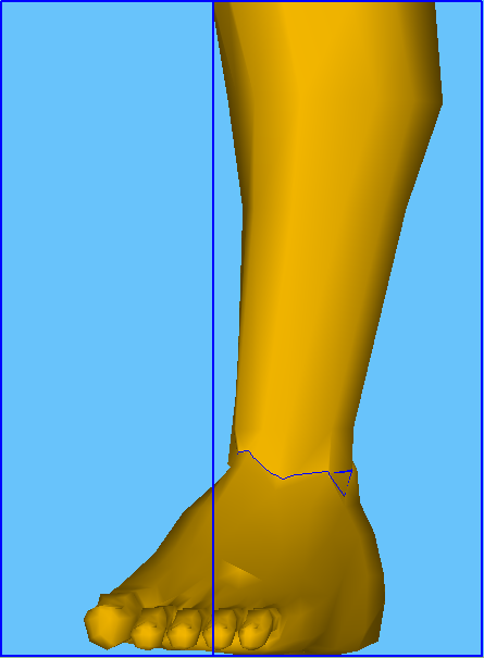

Step 2: Rotate and Render the 3d Object Using Only Paralel Projection
Very important in this next process is to use "paralel projection" instead of regular "perspective" camera. The next step was to take each and every object piece, rotate it, and render it after each rotation. The program I used had a rotation tool that allowed me to rotate it by 15 degrees. So I rotate every piece 12 times clockwise and made images of it.

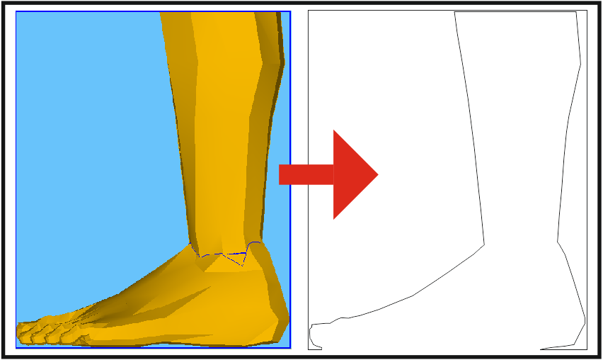

Step 3: Convert Your Images to Vector Hot Wire Path
Then I had to convert the outline of every object in every image into a vector tipe. When I converted my patterns to vectors I made sure that, at all times, the hot wire path doesn't go under my foam. You have to make the path of your hot wire to go around like in my picture (my hot wire cnc starts from the right side of the machine).

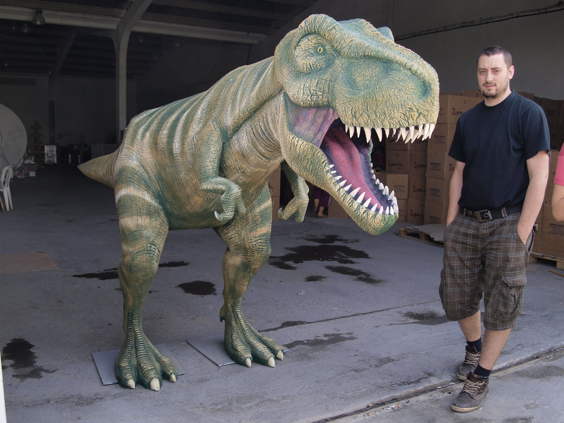

I know it looks like alot of work but once you have your shapes in a vector format you will be able to make your 3d object as many times as you want and as large as you want. I was able to make 2 pieces of 3 meters Anubis in like...10 days. So that's it. This is one way to convert your 3d object into a real life object and it's quite accurate. I know there are at least two other methods to do it, using the hot wire cnc, but I didn't make a tutorial about them... yet
